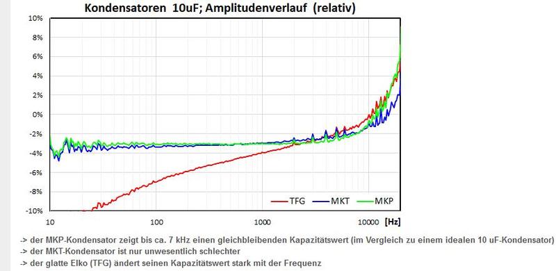

Unterschied Folie - Hi-Endfolienkapazitator messbar

    Fazit: Kein Unterschied mess/hörbar
    As the topics "capacitor upgrade" and therefore "capacitor sound" is very controversial, the test method and its results are explained in detail. This cannot be dealt with in one minute. Sorry for this and I hope your attention span is still sufficient to read through a long text - whereby the...
    Result: There is practically no measurable acoustic difference between the simple, ancient film capacitors and the current high-end capacitor. Welcome to reality!
    This clearly shows that the characteristics of the high-end capacitor cited above, such as "very transparent" or "very detailed" compared to other film capacitors, are pure fantasies of ambitious authors.

      Die Messungen sinds fast gleich also das Unterschied zum Hoeren muss denn natuerlich Gross sein.
      Elko verus MKP/MKT ist im Messung anders. ESR ist auch anders weil den Technik im Kondensatoren ist auch anders. Ein kleines Unterschied kann man auch hoeren.

          Den Toleranz zwischen Elkos ist Groesser. Wie schon im Artikel gemessen zwischen MKPs gibt es fast klein Unterschied. Aber schoen wenn Leute es glauben um die Verkauf so weiter zu gehen.

            "....Der ESR (= Equivalent Series Resistor) oder scheinbarerer Serienwiderstand sollte möglichst gering sein. Insbesondere bei tiefen Frequenzen (120 Hz) unterschieden sich die Kondensatoren deutlich (TFG = 3.543 Ohm, MKT = 0.3812 Ohm, MKP = 0.1518 Ohm). Bei 1 und 10 kHz sind die Werte fast identisch für alle 3 Kondensatoren...."
            Quelle:https://www.hifi-selbstbau.de/grundl...on-daytonaudio

              Conclusion
              For the same capacitance, there are measurable differences when comparing electrolytic capacitors against film capacitors (in series with the chassis), which depend strongly on the quality, especially the ESR, of the electrolytic capacitor.
              However, the difference in sound pressure in the measurements shown is only 0.2dB in the worst case.
              This is higher than in the first part when comparing normal film capacitors against a high-end capacitor, but in the end still insignificant (in most cases).
              If the electrolytic capacitor is of good quality, durability does not play a decisive role either.
              Only the high tolerance values of electrolytic capacitors and the possible change of the capacitance value over time could pose a problem. Especially when used in the tweeter crossover - this should be avoided.
              Very important: according to these measurements a film capacitor does not make a better sound when used in the crossover compared to an electrolytic capacitor.
              If you replace capacitors, especially electrolytic capacitors, with film capacitors in the crossover, without checking with an LCR meter, you will most likely notice a change in sound. However, 99% of the change in sound is only due to the different capacitances caused by the capacitor tolerances and not because the film or high-end capacitor "sounds better".

              Beim Vergleich einer "normalen" Weiche mit einer Hi-End-Weiche waren Unterschiede (minimal) hörbar, aber nicht messbar, wurde behauptet.
              Es wurde aber bewiesen, dass es sehr wohl messbare Unterschiede gab, die aber durch kleine Abweichungen in den Werten der Weichenteilen verursacht wurden.
              "So what we are likely to hear are not improvements due to more expensive components, but differences due to small component value" deviations."
              Mein Fazit: Bei Elkos ist Vorsicht geboten, Filmkondensatoren jeder Art sind gleichwertig, teurere Kondensatoren sind unnötig.

                            Ich möchte hier ja keinen Unfrieden stiften, aber ist das nicht etwas einseitig betrachtet, sich fast ausschließlich auf den Frequenzgang zu stürzen.
                            Betrachtet man das Verhalten in einem komplexen Signal sind dort Unterschiede von bis zu 6dB Impuls bei den harmonischen Verzerrungen sichtbar.
                            Da kann man wohl kaum von "keinem Unterschied" sprechen.
                            Die werden nun mal mitübertragen und auch wiedergegeben.
                            Eine entscheidende Größe dafür ist meiner Einschätzung nach auch der Lade-/Entladezyklus des Kondis, sowie die Leitfähigkeit der Folie.
                            Auch wenn letztere im Unterschied wohl nur gering ausfallen würde.
                            Außerdem sollte man vielleicht auch berücksichtigen, daß auf einer passiven Weiche ziemlich selten nur ein einziger Kondensator zum Einsatz kommt.
                            Mit anderen Worten, man sollte dabei vielleicht auch das Gesamtübertragungsverhalten im Auge behalten.
                            Insbesondere beim Einsatz von Saug- und Sperrkreisen innerhalb eines Zweigs.

                              Kannst du bitte mal Messungen dazu zeigen?
