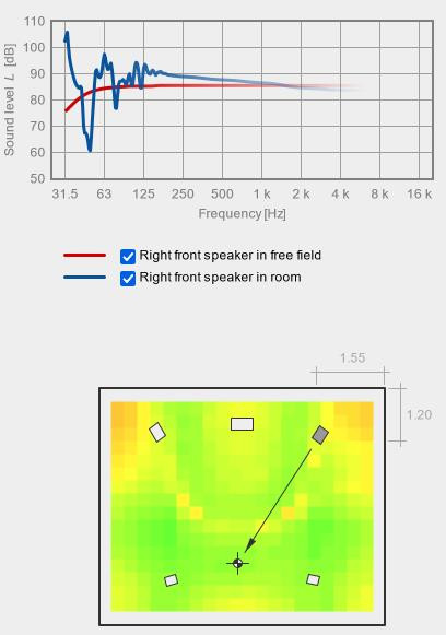

                    I've made a small sketch of your room:
Name: Listening position.png
Ansichten: 663
Größe: 36,9 KB
                    Could you please confirm the position of the speakers and your listening position in this sketch? Perhaps your listening position is in an area, where the bass response is very low because of standing waves.
                    By the way: With the following online tool https://www.hunecke.de/en/calculators/loudspeakers.html you can calculate the room and its response to different loudspeakers. It can help to understand your problem, even if exactly your speakers are not included in their list.
                      • 28519
                      I was eager....that looks real bad. Just a guess, no exakt positions. But there is hope: move the speakers to the backwall and there ist no leak of bass anymore.

                        The speakers are 135 cm from the side wall and 20 cm from the back wall.
                        Between the speakers are 2 column cabinets and a low cabinet with the installation.
                        Have already had measurements done and we saw a decent dip below 100hz.
                        The solution was bass traps and acoustic panels behind the speakers and on the opposite wall.
                        But this is unfortunately not allowed by the woman.
                        So we have to look for other solutions.
                        The only thing I can think of are speakers that give more bass.
