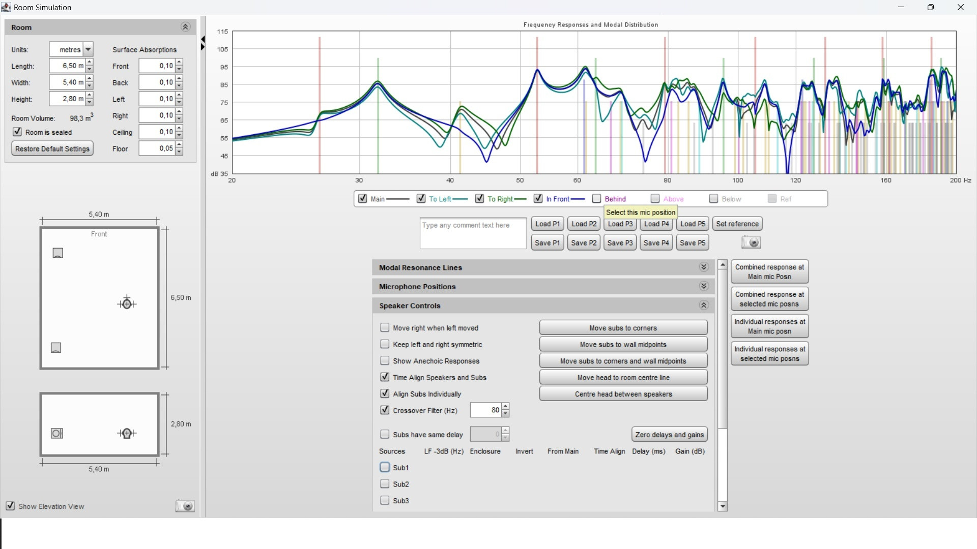

        Here are some measurements.
        • Lebrichon
          • 20.06.2008
          • 291
          Thank's for the measurements. They clearly show typical room acoustic problems and low bass between 35 - 50 Hz and 65 - 100 Hz. It's easy to imagine that you miss deep frequencies.
          Unfortunately, I have to say, that if you install woofers with more bass, the result will not get any better. On the contrary, the bass will become extremely loud on other places in the room than on the listening position.
          In my opinion, there are the following possibilities:
          1) Change listening and/or speaker position. For a small test, you can move the speakers a bit, to check if the bass response will get better. If the new speaker position is not acceptable for your wife, you can also install some rolls underneath the speakers to move them any time you want to listen to good music and place them back, when your wife is at home.
          2) Install an additional subwoofer, which can also be a hidden one (like behind a cabinet, underneath the couch or disguised as furniture)
          3) Invest a lot of time and calculation into room optimization, which is not easy for such deep frequencies. Of course, that can be an optical problem because for a hearable effect, they must get large.

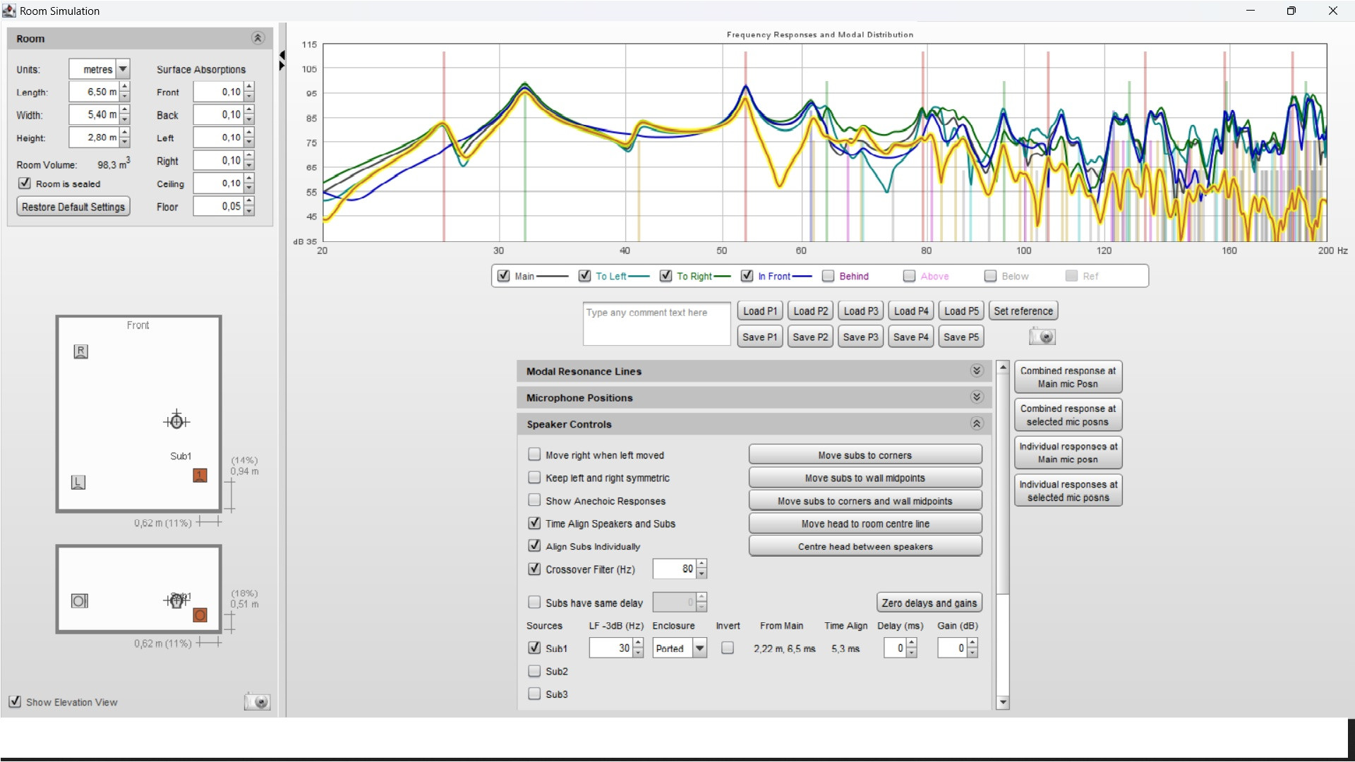

            But i think, lebrichon is right, its the room and position. If you add an aktive subwoofer this will fill the dips in the bass. If you buy an Antimode, the frequencyresponse is automatically better. If you do this, the Sub can be placed in a roomcorner behind your listening position. 30 liter, closed cabinet is enough.

                Jungs, ihr habt recht, der Raum ist scheiße:

                und mit SUB
Ansichten: 473
Größe: 344,7 KB
