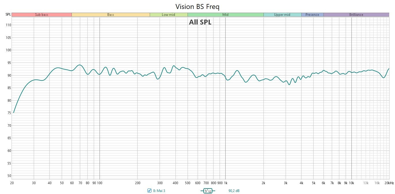

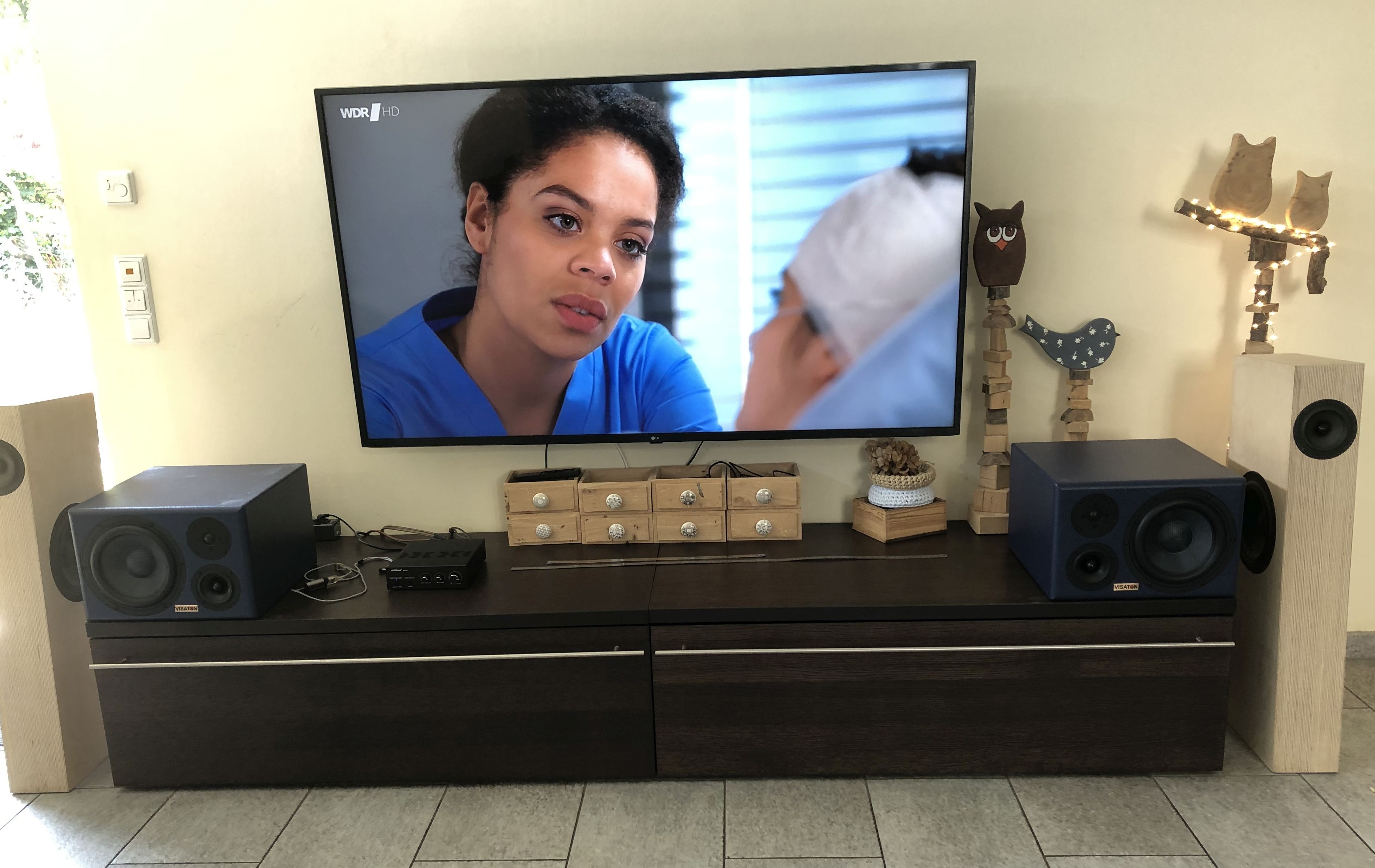

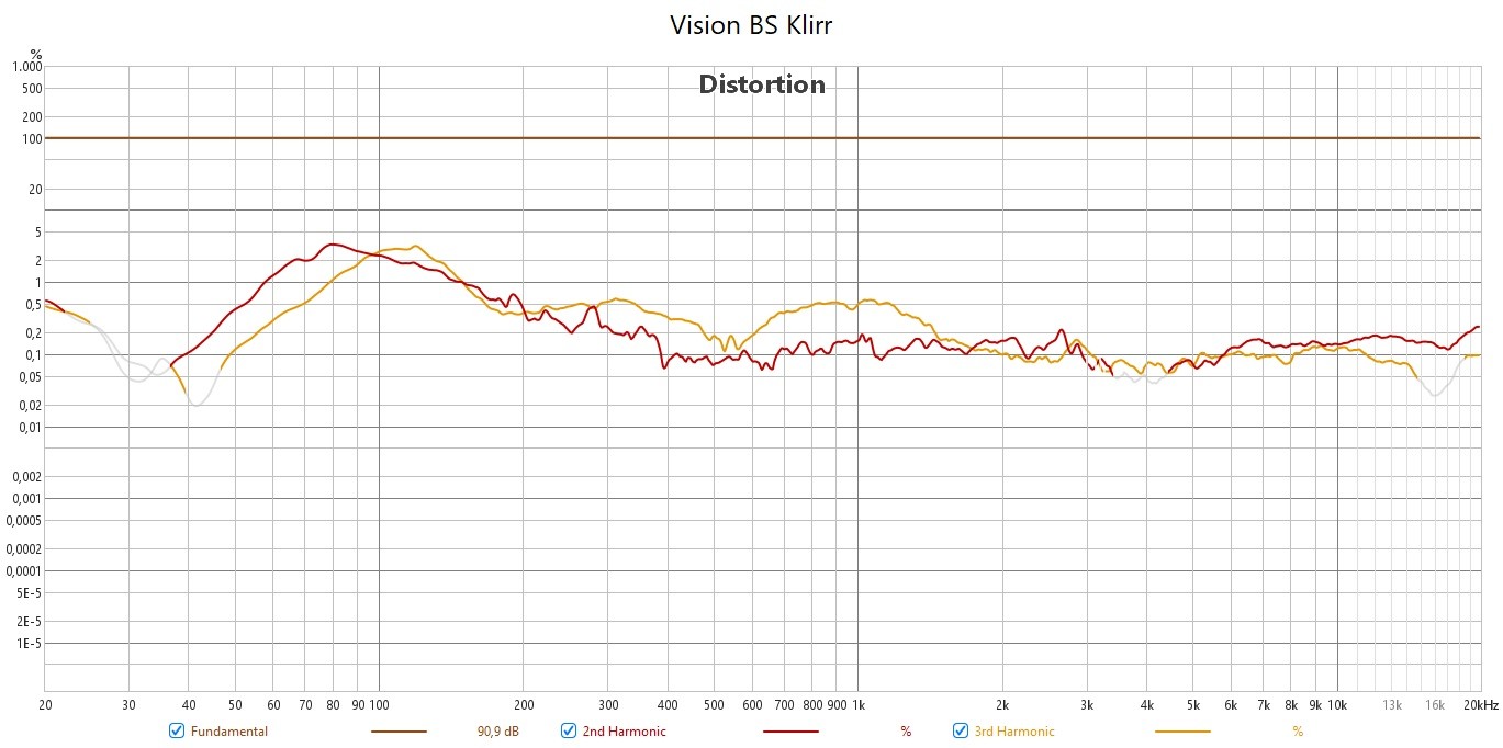

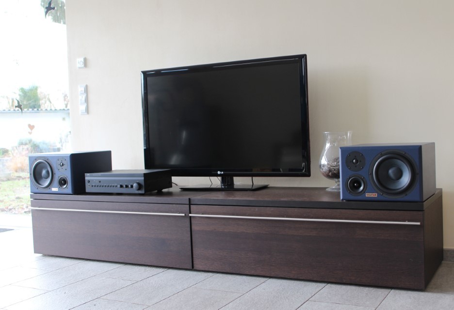

                  my english is not perfect,
                  i had in 2018 the Vision BS in my livingroom
                  i have measurment and pictures

                  the box is very good, but not loud. You have a "Kennschalldruck" with 82 dB, this is realy low.
                  in the maximum you can have 100 dB, not more. is this enough?

                    Hello David,
                    my TIW200XS ist working in 22 litres GHP/600uF in my Topas+8 ==> https://forum.visaton.de/forum/galer.../18018-topas-8
                    Perfekt bass for my room and my ears, f-3 about 35Hz.
                    Max SPL ist limited to about 100db ( as Timo wrote), if this is ok to you the Vision BS will be a pretty good loudspeaker!
                    Greetings to Canada!
