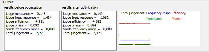

        Hello Uwe,
        Can you explain a bit how the results should be interpreted at the output of the Optimizer?
          • 5690
          Obviously the optimizer could do something positive at the beginning and then could not optimize significantly for a long time.
          The impedance response seems to be quite good according to the requirement. Frequency response is also very good, phase situation also very good. Efficiency could be better, maybe you do not need a box with PA like efficiecy and maximum power.

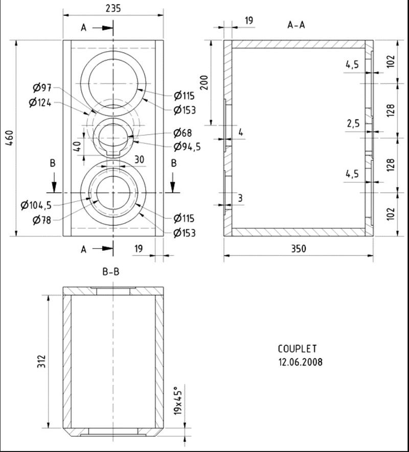

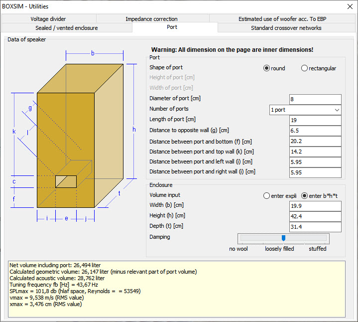

            Port BR25.50 in Boxsim
            Hello Uwe
            I want to build the Couplet but first simulate it in Boxsim.
            I encountered a problem there, namely the port BR25.50 which is an angle reflex tube. Is it correct that I enter the distance to the top wall for entering the distance between the end of the tube and the opposite wall?
            See topic on forum.zelfbouwaudio.nl
            Thanks,
            Willy

              I think it is corrct, because what matters is the position of the inner end of the tube relative to the walls.
              Consequently, the distance to the front and back walls should be entered as distance to the top and bottom walls.

                I do not understand the latter well, I think I only have to deal with top-wall when entering "Distance to opposite wall (g) [cm]".
                All the rest speaks for itself since there the position concerns the output of the port in the rear wall.
                See attachment with my input values for the port in box COUPLET.
                COUPLET construction plan also attached.

                  Hello Willy,
                  I made a little sketch of my interpretation of the dimensions f, g, and k in this case.
                  If the inner end of the tube is close enough to a wall, the air flow is restricted to a smaller cross-section, which acts like as an extension of the tube length. Therefore it seems reasonable the dimensions I indicated should have an effect on the tuning frequency, although I don't know how the the tool works in detail. There is no such effect at the outer end of the tube.

                    Thanks Fraggle for de clear description.
                    Now I understand what you mean and I think you are right.
                    The exact location and size of the internal port determines the tuning frequency, I am convinced of that.
                    In this case, it is probably less important where the port's output is in the box and we should therefore only indicate that it is in the center of the panel. The other dimensions belong to the internal input of the port, but that is not really easy to enter in the tab of the port.
                    UweG (developer of the software) probably knows how to enter it correctly.
                    Update: I found another error when entering the geometric volume per AL130, I can only enter half of the total geometric volume there, so 13.1 instead of 26.1 ...
                    Moreover, I have found a tuning frequency of 45Hz in the official BPJ file of the COUPLET, perhaps I should also copy that myself.

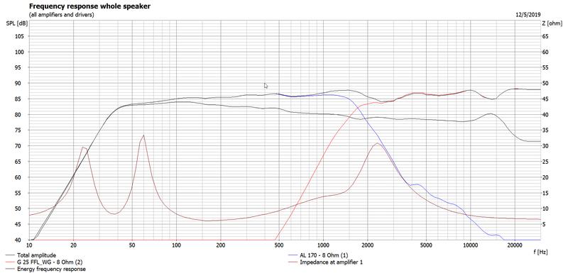

                      I would have a question: what does actually "Energy frequency response" mean on the FR graph on the main window?
                        • 28875
                        5. What is meant by energy frequency response?
                        The Energiefrequnzgang is the frequency response of the sound energy that radiates a box, regardless of the direction in which the sound is emitted.
                        Frequency responses usually refer to the sound a box radiates straight forward. Indeed, in a low-resonance ("dead room") room, one observes that speakers with similar frequency response in the main emission direction also sound similar when sitting in front of them. The same can be observed under free-field conditions. In a living room, however, one notes that speakers with the same frequency response on the axis sometimes produce a very different timbre. The reason for this is the indirect sound, that is, sound components that do not get straight from the speaker to the listener, but are partly reflected several times on the floor, ceiling, walls or pieces of furniture before they reach the ear of the listener. Obviously, this sound originally did not necessarily have to be emitted in the direction of the listener.
                        The energy frequency response provides a measure of how strongly the room is excited with diffuse sound components, which arrive as indirect sound at the listener. Especially with large hearing barriers and with reverberant rooms, it should be emphasized that the energy frequency response in the range above approx. 250 Hz is as straight as possible. The frequency response below about 250 Hz has little effect on the timbre, but is perceived separately as more or less bass.
                        http://www.boxsim.de/faq.html

                            The acoustic power response (so called in the english version of Boxsim) is the frequency response of the sound energy that is radiated by a box, regardless of the direction in which the sound is emitted.
                            Frequency responses usually refer to the sound a box radiates straight forward. Indeed, in a low-resonance room (anechoic chamber), one observes that speakers with similar frequency response in the main emission direction also sound similar when sitting in front of them. The same can be observed under free-field conditions. In a living room, however, one notes that speakers with the same frequency response on the axis sometimes produce a very different sound color. The reason for this is the indirect sound. That means sound components that do not get straight from the speaker to the listener, but are partly reflected several times on the floor, ceiling, walls or pieces of furniture before they reach the ear of the listener. Obviously, this sound originally did not necessarily have to be emitted in the direction of the listener.
                            The sound power response provides a measure of how strongly the room is excited with diffuse sound components, which arrive as indirect sound at the listener. Especially if listened in a large distance and/or in a heavy reverberant room, it should be emphasized that the sound power frequency response in the range above approx. 250 Hz should be as flat as possible. The frequency response below about 250 Hz has little effect on the timbre, but is perceived separately as more or less bass.
                            In the german version I avoided to use the word Schalleistungsfrequenzgang (word by word translated: sound power response), because this is a word used in the german standard DIN EN ISO 3740, but with different meaning. In the standard 0 dB is defined as 1pW of radiated sound energy. This is not the 0 dB of sound pressure level (20µPa) in 1m. The difference is about 11 dB.
                            In Boxsim the sound power response is identical to the frequency responnse on axis, if the speaker radiates the same amount of sound in every direction.

                              Currently, I have something like the one attached to the post. Any comments on it?
                                • 5690
                                Not in this thread. This one is for the english version of Boxsim.
                                Please open a new thread and maybe attach the project file because frequency response is not the only interesting topic.
