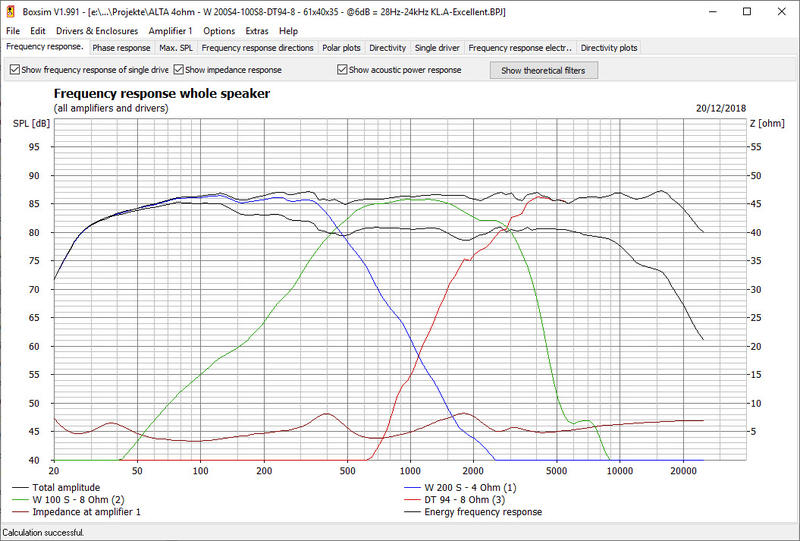

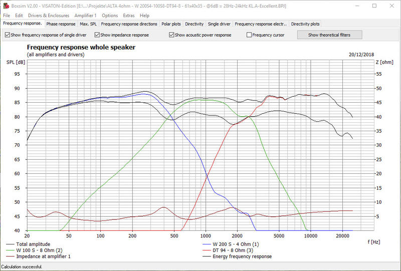

                Good morning UweG,
                Thanks for de new version!
                Is it normal that the new driverfiles give such a difference between V1.99 and V2.0?
                The crossover circuits are identical.
                  • 5690
                  No and yes and no.
                  No, V2.00 should produce almost the same results on axis and similar results off axis, if you use exactly the same driver files.
                  Yes, the driver files have changed. If you use the old driver files with 2.00 you'll get very similar results compared with 1.991.
                  No, I tried to simulate a similar box with the same chassis files (new and old), but the difference I get goes in the same direction, but is smaller. Could you please upload the BPJ file for the 1.991 project. I will check what happens when I'm updating the drivers.

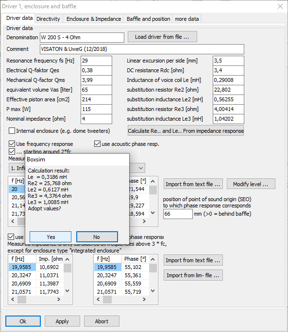

                    I have supplied the "BPJ" from V1.991.
                    Every time I load a driver, I also click "Calculate Re .. and Le .. from impedance response" and then OK.
                    I also loaded the new drivers without doing that but the result is still worse than in V1.991.
                      • 5690
                      Hello Willy,
                      thanks for the file. When I load it in 1.991 and 2.00 and always refuse any update of the drivers, I almost et the same results. There is about 0.2 dB more in the lower frequencies in 2.00. That is what I expected.
                      when I'm now updating the drivers, that means "Load new driver from file.." and then choose the new driver file, in fact the result is what you already got.
                      I clicked "set current project as reference", before I updated the driver files. So we see the simulation from 2.00, but with the old driver files in the background (in lighter colors).
                      Obviously the drivers ave changed over the year since 2005 and 2008. May also be that the W200S-4 had some issues with the setup in the old measurement.

                        So the only solution is: re-run optimization with the new drivers (these are the most correct ones, I hope).
                        My way to run and apply the calculation of RE .. Le, after the driver load, is ok?
                          • 5690
                          It is o.k., but not neccessary. This function is primarily for use after you imported another impedance response, if you do your own measurements.
