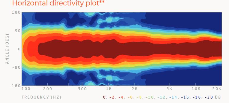

    Dutch and Dutch 8C -WOW
    Discover how your music can sound, when your loudspeakers work together with the acoustics of your room.

Name: sono dutch.jpg
Ansichten: 526
Größe: 95,1 KB

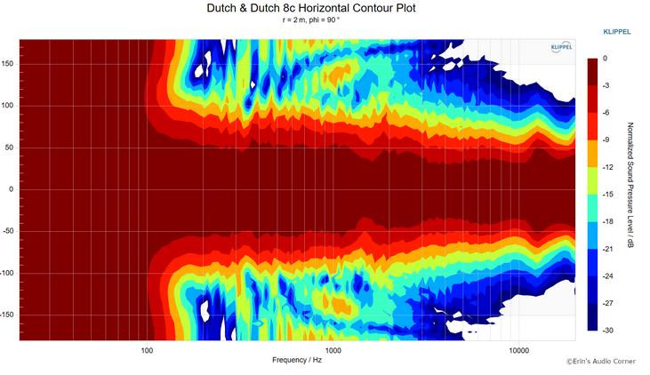

              • This speaker sounds phenomenal.
              • Objectively speaking, the data indicates this is a terrific speaker. It is roughly ±1.5dB from 30Hz to 18kHz. That’s incredible.
              • The data does indicate something - possibly a resonance - around 400Hz which appears to be caused by the 8-inch midrange (judging by the nearfield response). However, there was no hint of this when I specifically listened for this as an issue. Therefore, it could be another source or simply inaudible (Toole discusses this in his book )
              • There is also a mild directivity mismatch at the crossover, but I am impressed it is so minimal given the size of the midrange and the center-to-center spacing of the tweeter/midrange. Of course, the 1250Hz crossover helps to alleviate this, though one expects an increase in distortion from the tweeter with such a relatively low crossover point. While the distortion profile is higher at 1kHz than at 2kHz , it appears this portion of the distortion profile is due to the midrange and not the tweeter. sdw There is no way to know for sure without testing the raw drive units with implemented crossover but I think that’s too far down in to the weeds (even for me).
              • Speaking of distortion, yes, the measured harmonic distortion is relatively high. But, in my listening tests I had this speaker playing as high as 105dB @ 4 meters with no audible distortion other than the things that were buzzing in my living room. I even used test tones to see if I could hear the distortion in my MLP but, alas, the fireplace was vibrating as were some of the items in the bookshelves.
              Dutch & Dutch 8c Speaker Review
                • 07.01.2003
                • 28884
                #142

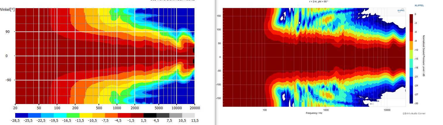

                Klicke auf die Grafik für eine vergrößerte Ansicht  Name: sono conwg dutch.jpg Ansichten: 0 Größe: 208,9 KB ID: 708770
                Ja, wobei die Concorde WG ähnlich ist.
                Vertikal ist die Dutch eindeutig besser, auch ist sie mehr CD. Im Klirr gewinnt die Con. Aber die D&D ist eine hervorragende Box, Einmessung wird als Servive angeboten.
                Mit 10 Mille ist man dabei.
                Fazit
                Die Dutch & Dutch 8c bringt die Qualitäten eines exzellenten Studio-Monitors in das heimische Wohnzimmer: Der aktive Drei-Wege-Kompaktlautsprecher spielt ungemein klar, offen und präzise, das Klangbild ist neutral, auch außerhalb des Sweet Spots verfärbungsfrei und bietet einen überraschend kräftigen Bass. Dies ermöglicht das akustische Konzept der 8c: Einerseits wird der Schall durch Waveguides vor den Chassis geführt, andererseits wird der Mittteltöner durch seitliche Gehäuseöffnungen zum Cardioid-Lautsprecher, wodurch er überwiegend nach vorne strahlt und ungewünschte Raumreflexionen vermeidet. So wird der Raumeinfluss reduziert – und so ist eine wandnahe Aufstellung möglich, die für die Basswiedergabe auch gewünscht ist: Die beiden Subwoofer strahlen zur hinteren Seite und bilden mit der Rückwand des Raums ein akustisches Wiedergabesystem. Um den ansonsten klangverschlechternden Einfluss des Ambientes zu egalisieren, lässt sich die 8c durch den integrierten Soundprozessor auf den Raum anpassen und klangoptimieren. So kann der mit 1.000 Watt-Verstärkern bestücke Lautsprecher ungeachtet des Raums seine akustischen High End-Qualitäten ausspielen – und die sind derart exzellent, dass man mit der 8c ein musikalisches Entdeckungserlebnis hat.

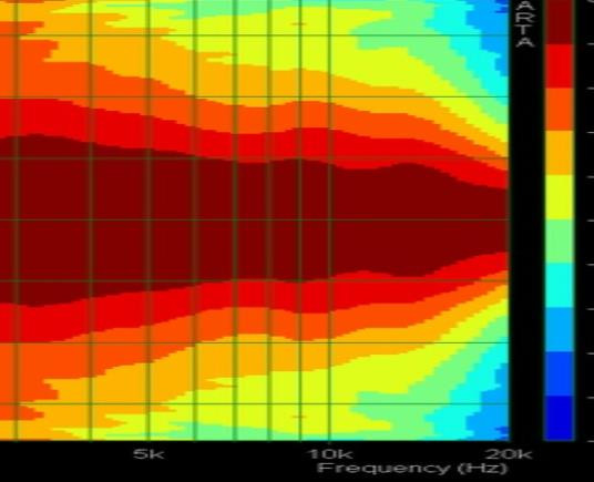

                    Zitat von walwal
                    Simulation Heco Hochtöner
                    Viel Wirkungsgrad, hoher Maximalpegel, hohe Natürlicghkeit eine genial Impuls- und Bassgenauigkeit: die Heco Celan Revolution 9 im LowBeats Test
                    übliche Frontplatte
                    Fluctus Frontplatte
                    Von "besser" weil "breiter abstrahlend" würde ich hier nicht sprechen. Mit der Fluctus-Frontplatte ist der Frequenzgang ungleichmäßiger und bündelt im oberen Hochton stärker. Sieht man dem inneren Bereich der Schallführung durchaus auch an. Mit der Standardplatte verläuft der -3dB-Bereich schön gleichmäßig.
                      • 07.01.2003
                      • 28884
                      #145
                      Ich sehe das genau andersrum: Die Fluctus strahlt eindeutig breiter. Auch nicht ungleichmäßiger, wenn man das in Relation setzt.
                      Das sind aber Simulationen, die müssen nicht korrekt sein.
                      Zitat Hifi Test
                      Hier scheint sich die Neuentwicklung, der Fluctus-Hochtöner, perfekt auszuzahlen: Die 0- und 15-Grad-Kurven sind nahezu identisch und auch die 30-Grad- Kurve weicht kaum vom vorgegebenen Kurs ab
Ansichten: 141
Größe: 79,2 KB

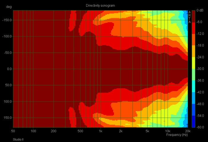

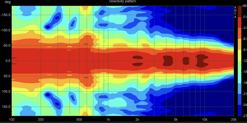

                            Klicke auf die Grafik für eine vergrößerte Ansicht  Name: SonogrammAbstrahlcharaktertistik_Fluktus.png Ansichten: 0 Größe: 58,6 KB ID: 729631
                            Klicke auf die Grafik für eine vergrößerte Ansicht  Name: sono s2.jpg Ansichten: 0 Größe: 49,8 KB ID: 729632
                            Studio 2....

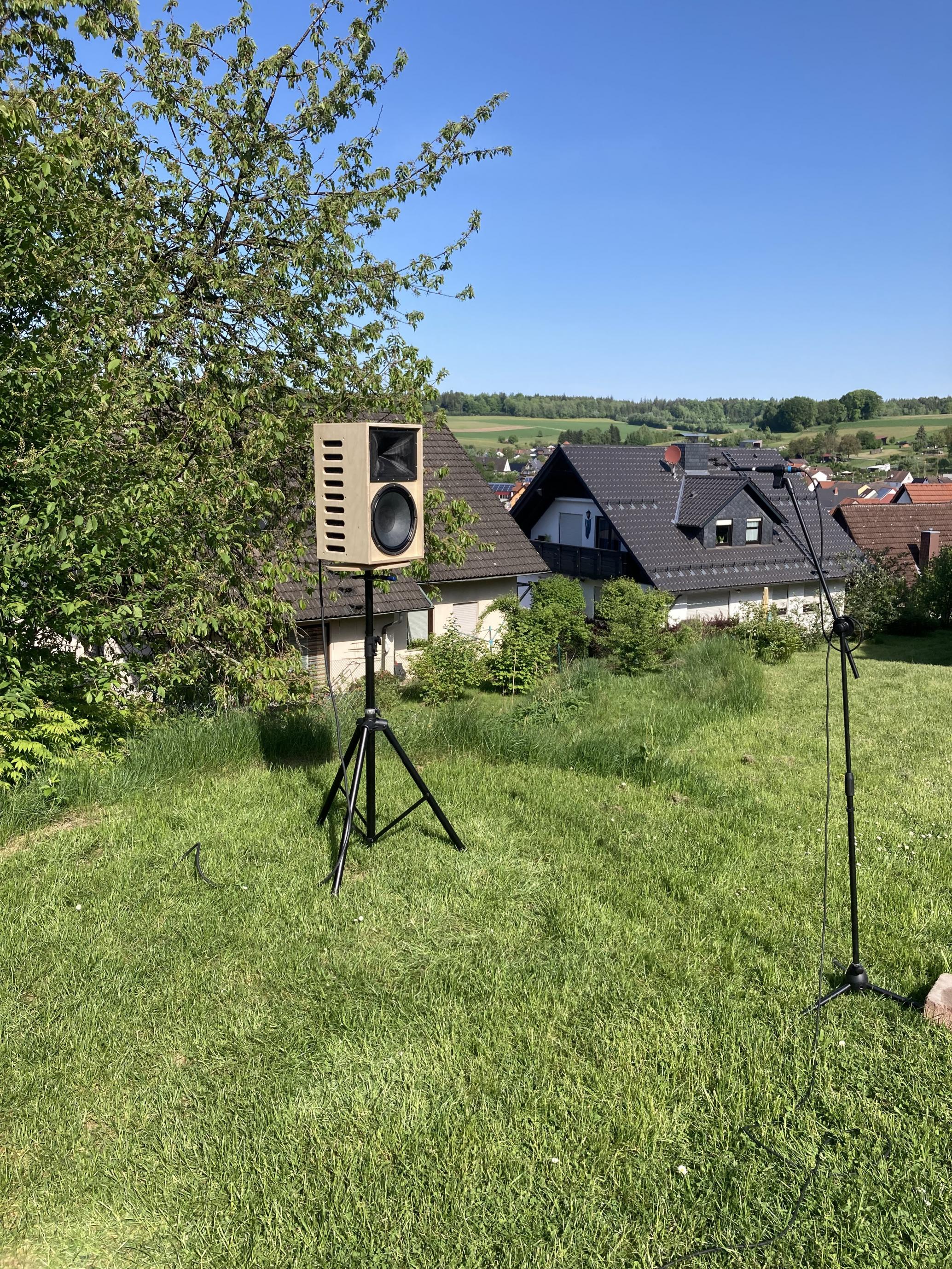

                              Selbst entwickelte PA Box
Ansichten: 334
Größe: 1,61 MB
                              Klicke auf die Grafik für eine vergrößerte Ansicht  Name: obenaltuntenneu.jpeg Ansichten: 0 Größe: 127,4 KB ID: 729640

                                #150
                                Super.
