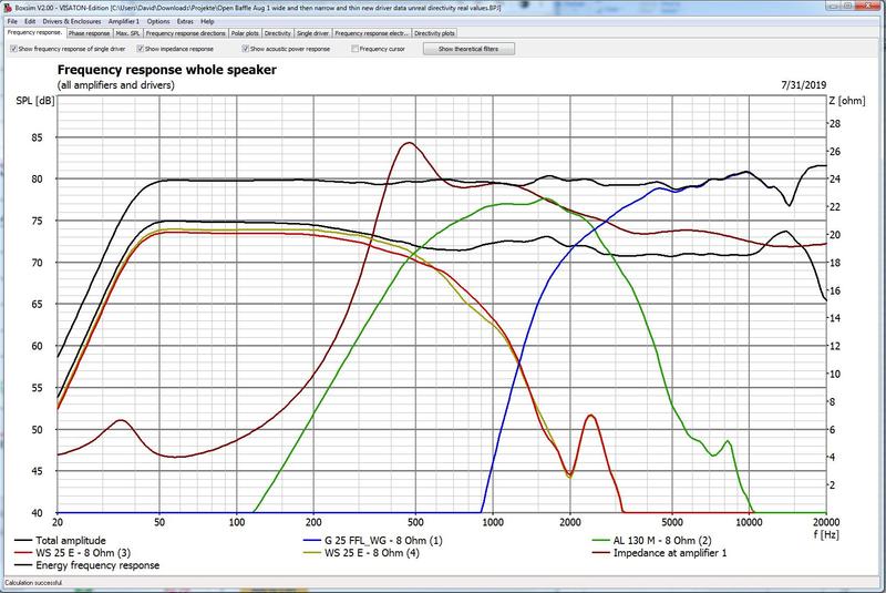

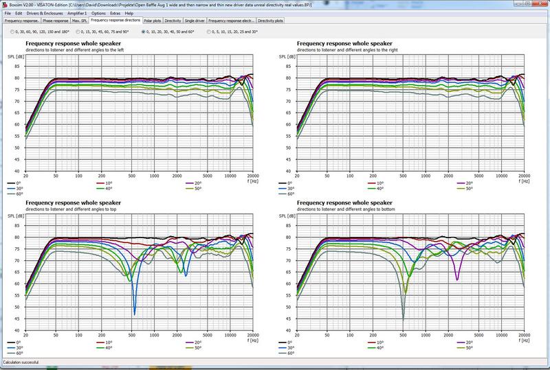

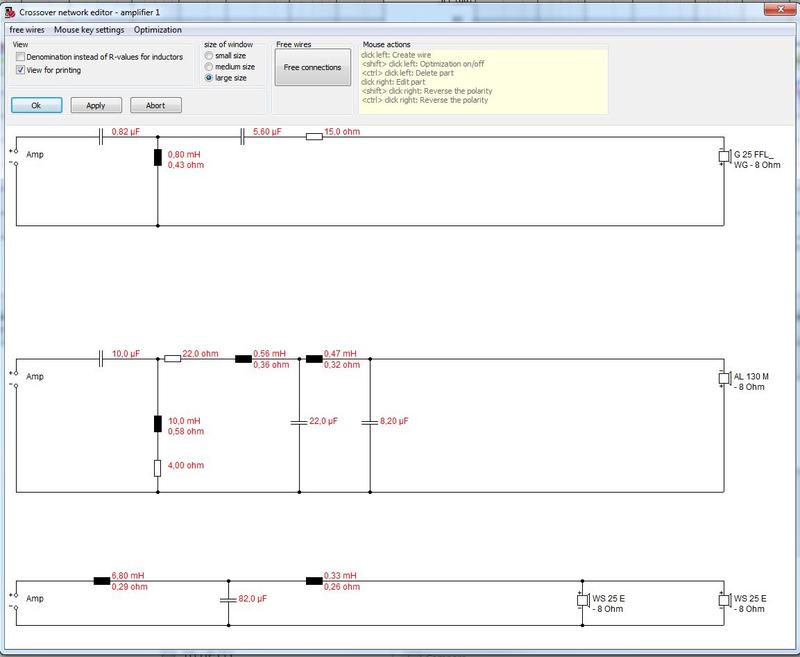

          Update Aug 1, G25FFL in Waveguide
          Hello there,
          I have made a few changes to the design. I changed to the G25FFL in a wave guide for a tweeter and changed the baffle to a 2.5 cm flat panel with a smaller narrow baffle above it for the mid and the tweeter.
          Here are the measurements,
          If the real speaker is anything like the simulation, this looks very very good.
          All crossover values are actual values that can be purchased at a store with correct resistance.
          The directivity is incredible
          (Die Direktivität ist unglaublich)
          Do you think the real speaker will be anything like this when built?

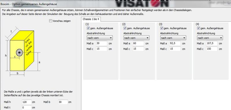

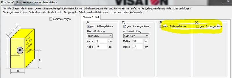

            The Positions of the AL an G25 on the Baffle are wrong!
            -firt you have to place all drivers in correct Position (option common outer housing) on a baffle with an heigt of maybe 110cm and 30cm width.
            -then you can type in a thinner baffel for the AL and G25 on (enclonsure and baffle)
            -at least you can type in a lower baffle for the ws25...
            It would never be 100% correct because Boxsim didn't know that the baffel under the AL grow from 15cm width to 30cm... Or in the other way that over the WS25 the baffle is 15cm...
            Here is the Project as I think its more correct.
            Regard Nils

              nlcarbon,
              I thought I was placing a small baffle above the large baffle with the settings.
                • 15.02.2012
                Thats right, but I think you have a mistake in the driver height. The AL in your project is on 52,5cm in vertical axis + 20cm (the middle of the small 40cm baffle). So Total 72,5cm. That doesn't fit with a WS25 on 60cm.
                The second is that a "more correct" baffle to calculate for the AL an G25 is 120x20 for exaple not 40x20. Because the drivers "see" the baffel from the WS25...

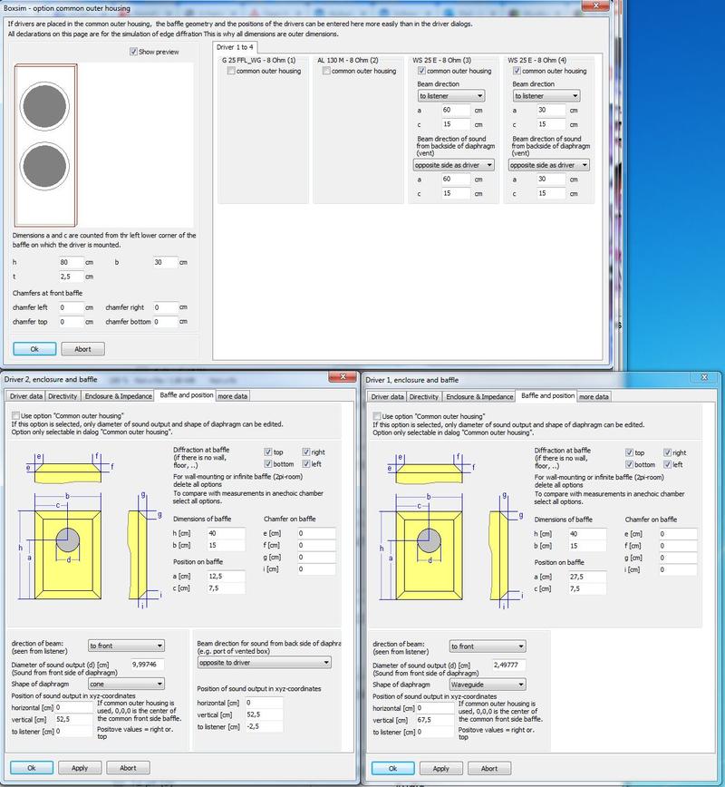

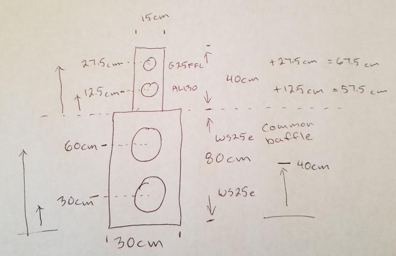

                  Here is from the box where you enter the data,
                  "Position of sound output in xyz coordinates"
                  "If common outer housing is used, 0,0,0 is the center of the common front side baffle. Positive values = right or top"
                  I thought that meant that if my common baffle is 80cm tall, and I wanted the AL130 to be at 92.5cm Y, that would be 1/2 of common baffle height (40cm) + 52.5cm.
                  Am I not understanding how the baffle layout works?
                  I have attached a quick sketch I made.
                  Thank you,
                  David.

                    • 28643
                    Step 1:
                    Step 2:
                    Step 3:
                    Same with speaker 4...
                    This ist just a simulation and not the reallity, you have to measure it or... try and error...

                            From what I posted in #23, I take it my settings don't match my drawing.
                            Where in space is my tweeter and midrange with my settings? In front of the woofers?
                            Zuletzt geändert von DaveFred; 03.08.2019, 03:39.

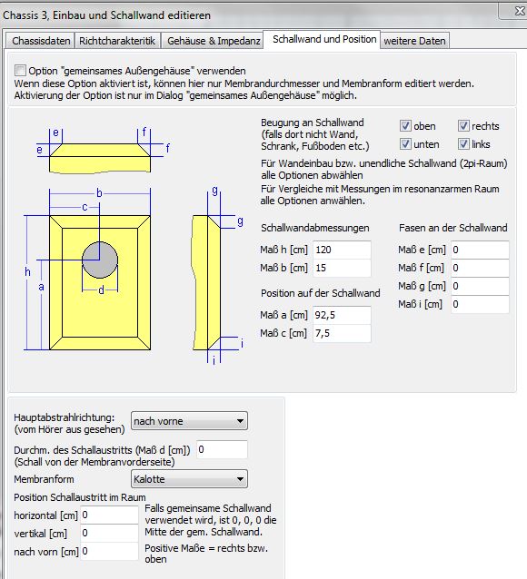

                              I think we have to distinguish two different points.
                              1. Formally, the settings posted by DaveFred in #23 represent the drawing correctly.
                              The note in Boxsim says: "If common outer housing is used, 0,0,0 is the center of the common front side baffle."
                              (@nlcarbon: In my opinion, this means the center of the large baffle and NOT the small baffle.)
                              We are using a common housing here, and its center is 40 cm above the floor.
                              Therefore, y = 52.5 cm places the AL130 at 92.5 cm above the floor.
                              2. Acoustically, there is only one baffle with a special shape.
                              As Boxsim cannot simulate this case accurately, the resort is giving each driver a recangular baffle that comes close to the real situation.
                              Therefore, 15 x 120 cm for the midrange and tweeter, and a 30 x 80 cm for the woofers seems reasonable.
                              Keep in mind you are only using a "trick" to simulate the open baffle. Boxsim does not have measured frequency response data for the rear side of the speaker. It does not even know the size of the radiating area on the rear side. So I am not sure how accurate the simualation can be.
