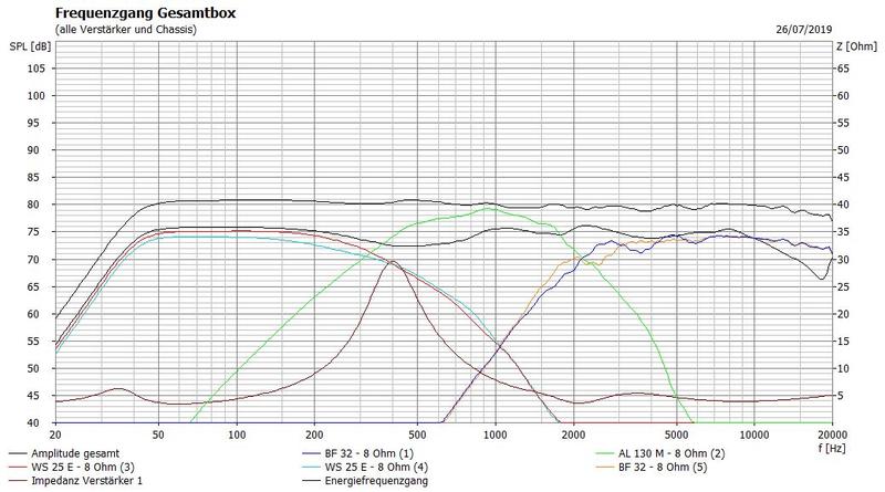

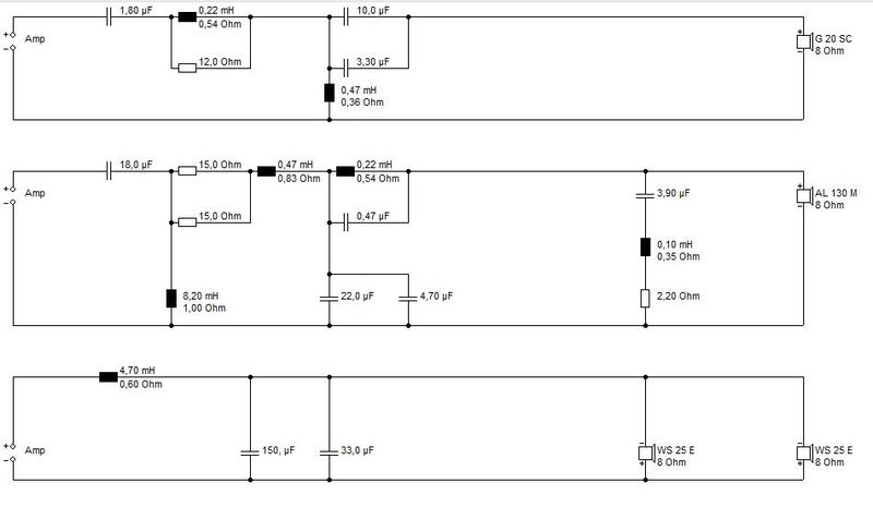

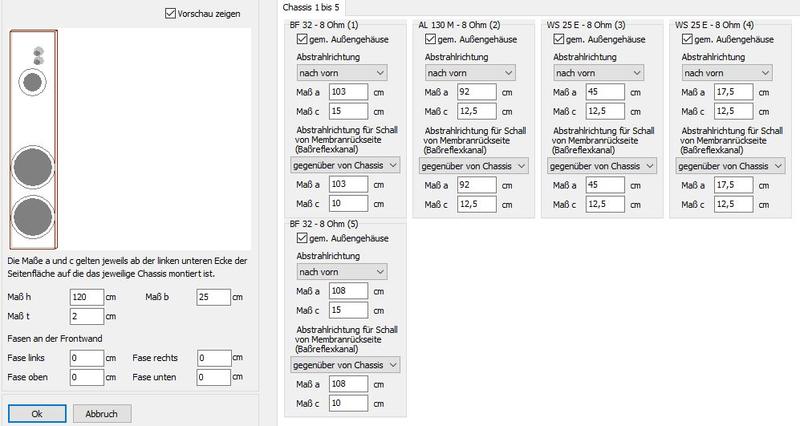

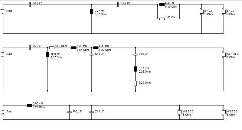

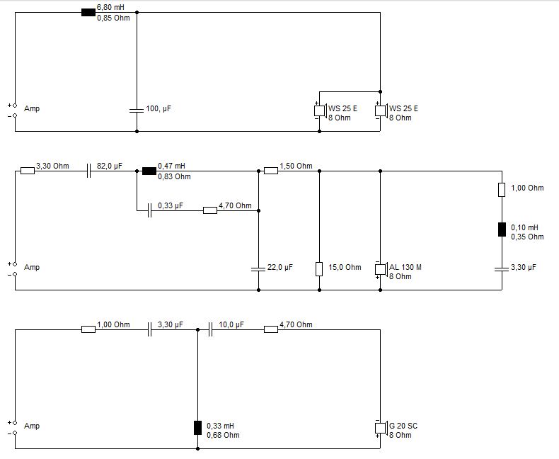

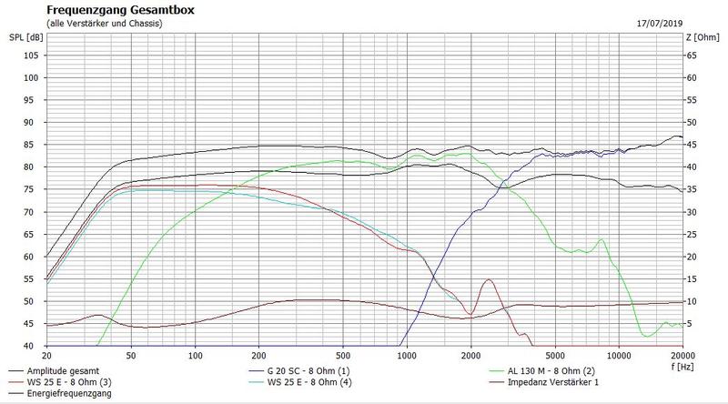

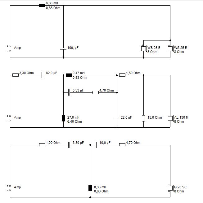

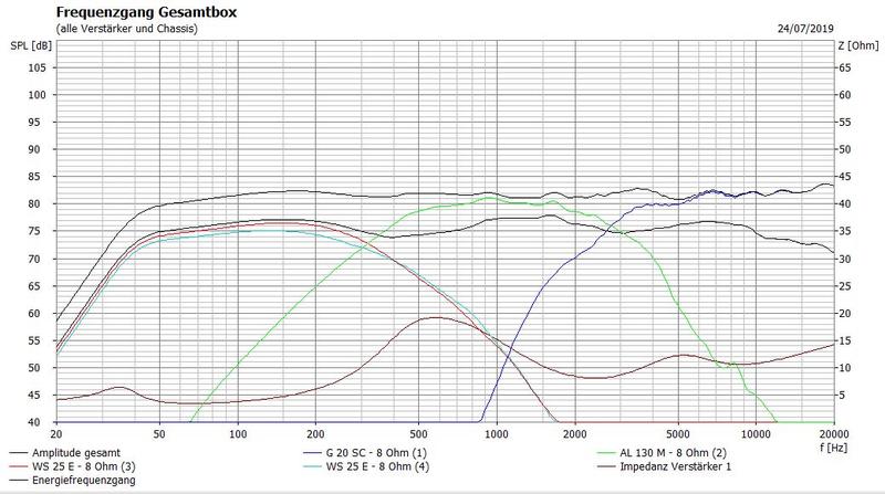

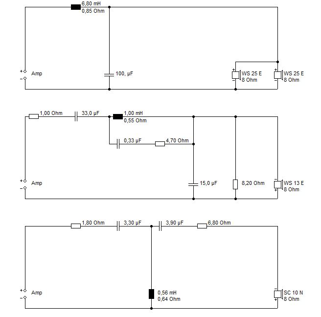

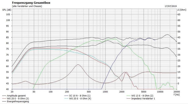

I am looking to make an all Visaton open baffle speaker with a maximum width of 38cm and maximum height of 120cm.
The budget is to be modest using a pair of inexpensive high QTS WS25E-8 10" woofers, an AL130M-8 for the important midrange and the G20SC for a tweeter with good off axis response.

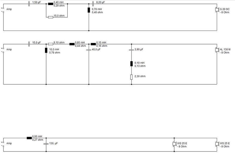

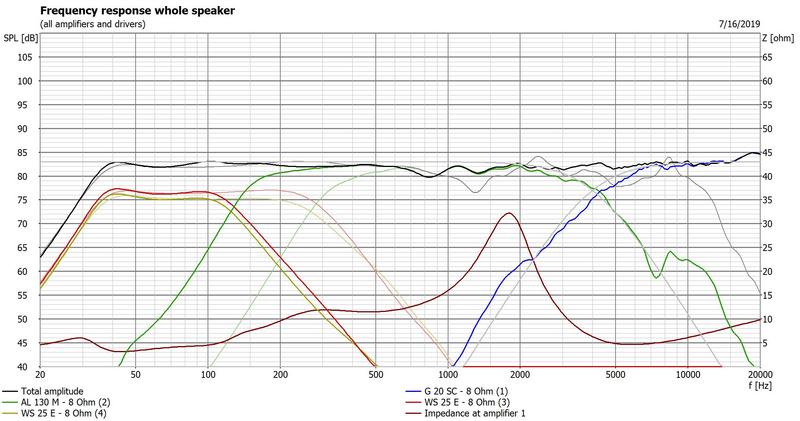

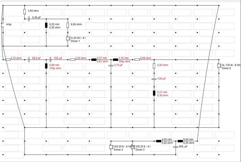

I have attached a few graphics and the .BPJ file if anyone wants to look at it.

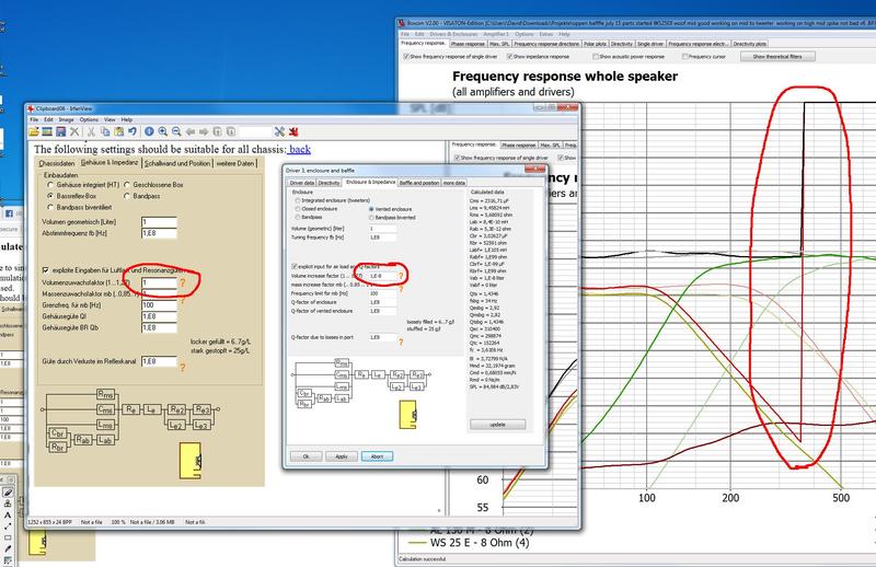

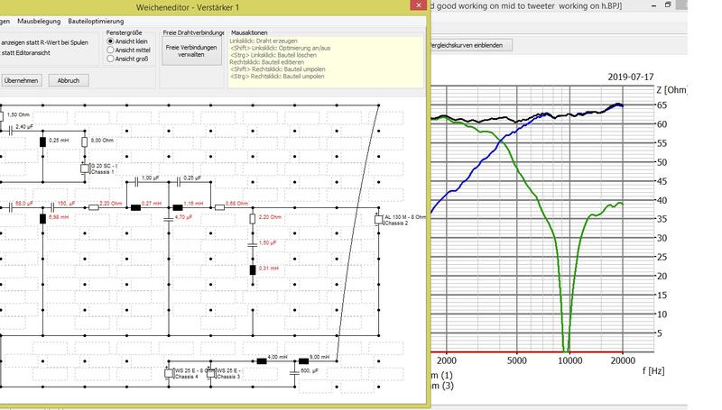

I followed the open baffle instructions for Boxsim at,
But I had a little problem with the woofer settings, when I set the "Volume increase factor" to 1, the woofer response jumped to the top of the chart. When it changed it to 0.0000001, it seemed to work. I hope this does not make the results invalid.
What do you think?
