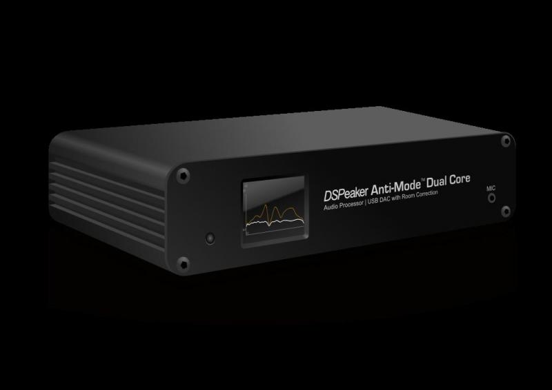

    Morgen wird das neue Antimode vorgestellt. Preis etwa 800 Euro.
    Vorläufige Info aus dem HiFi-Forum;
    Name: Anti-Mode 2.0 DualCore
    PROCESSORS:
    2 x VS8053 IceDragon (Audio DSP)
    1 x VS1000 (CPU)
    FEATURES:
    Automatically corrects any stereo system with user-defined frequency range
    Remote Controller
    Does not need PC
    Alternatively can correct multi-subwoofer systems
    Can be used as a digital 1.1 cross-over
    Measures and displays the room response on built-in TFT display
    Supports multiple measurement points
    Custom parametric EQs (notching, peaking, lowpass, highpass)
    Easy to use House curve and Tilt-curve tools
    Supports several independent “sweet spots” selectable with remote controller
    USB-DAC
    S/PDIF DAC
    Color TFT-Display
    Dual 6MHz oversampling multi-bit DAC per output channel
    Dual 192kHz ADC per channels
    Pure Digital mode (Optical)
    VSVDC digitally controlled analog volume control
    CONNECTIONS:
    2 x Gold-plated balanced XLR / RCA inputs
    2 x Gold-plated balanced XLR / RCA outputs
    USB connector
    Optical Toslink S/PDIF input
    Optical Toslink S/PDIF output
    DSPeaker datalink connector
