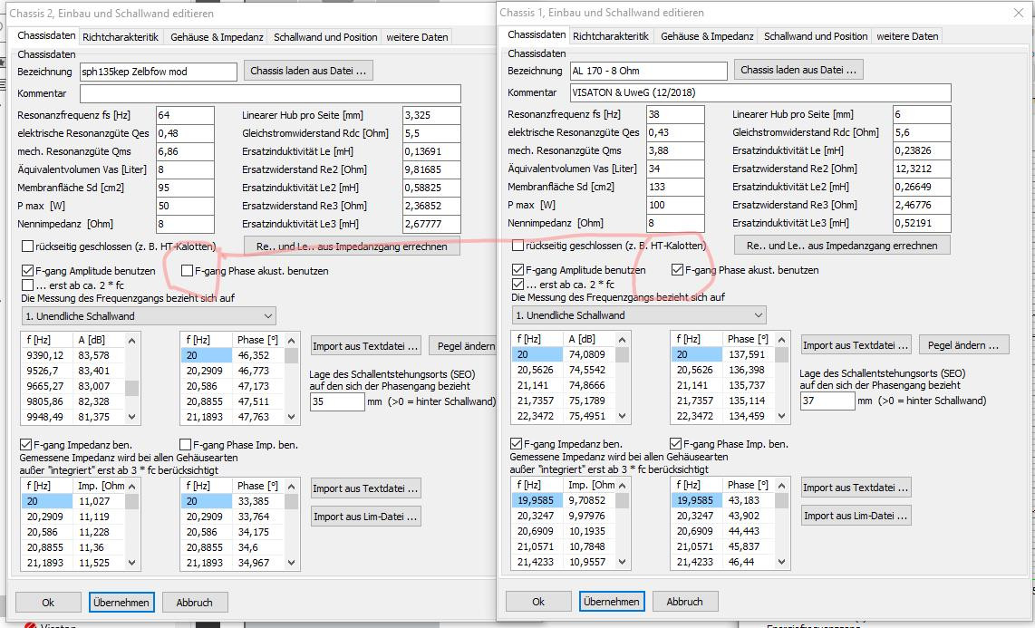

        Specifically, I have long since inserted the measurements of the actual box that will be used since it is already available, those of the transducers and their specific positions on the front panel.

          Can you please show the measurements or, better, your Boxsim file?

            zelfbow.BPJ
              • 28814
              Looks good.
              Why did you not use this button?

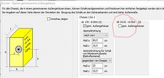

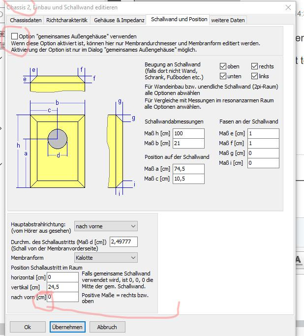

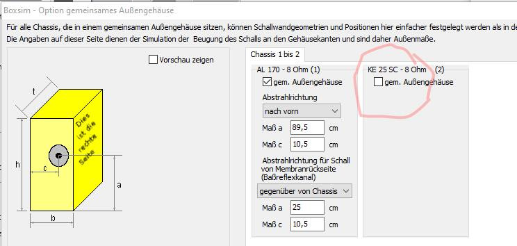

                • 28814
                The frequency-response in Boxsim is good, but how does the measured Frequency-response looks like?
                If jou wont to change the speaker-position, you can do it this way, instead of manipulating the SEO.
Ansichten: 165
Größe: 63,4 KB
Ansichten: 143
Größe: 117,9 KB
                • and
                  and
                  • 22.04.2022
                  • 6
                  I didn't check the phase button because I only entered the frequency response and impedance. The software calculated the respective phases. I have no idea what the measured frequency response looks like because I haven't acquired the necessary equipment yet. Unfortunately, I can no longer change the cabinet since it's finished as per the preview. The cabinet dimensions had been established in advance based on the manufacturer's recommended volumes. Then I discovered BoxSim and realized that perhaps they weren't the best dimensions.
