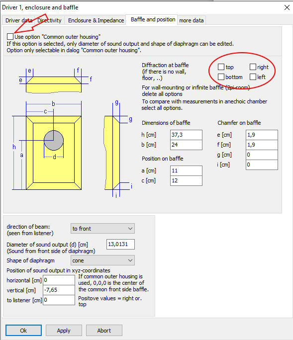

          Good evening and,

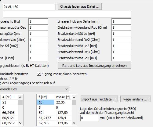

          if I understand you correctly, Boxsim shows a different simulation response at low frequencies compared to other simulation programs.
          Boxsim was designed to consider baffle geometry (and driver position on the baffle) to the simulation. If you want to compare different simulation programs, you have to ensure to give identically specification of baffle in every program, ideally a infinite baffle (i.e. half room conditions).
          To achieve this in Boxsim ( I assume you use the Boxsim V2.0 english version) you have to switch off 'use option common outer housing' and also all points at 'diffraction at baffle' in the enclosure and baffle --> baffle and position section, as picture shown below.

            Zitat von RobPl Beitrag anzeigen
            "With SEO, Uwe had already said, the same value must be with all chassis."
            as recently tested, that is not correct. The exact SEO, relative to eachother, should be added.

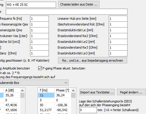

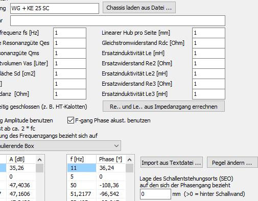

            Sorry, that ist wrong. Please read:
            ".....if you want to create a simulation with your measured data, as Jürgen said, always measure all chassis from a micro position.
            Then the phase reference of the chassis is automatically tuned to each other. With SEO, Uwe had already said, the same value must be with all chassis. Which one does not care. It is not about the exact phase, but only about the phase reference of the chassis to each other....."
            The following proofs my point:
            My loudspeakers were measured by Visaton
            Concorde-WG-KE25SC messung.BPJ
            Here you can see that the SEO of all speakers ist zero:
            Klicke auf die Grafik für eine vergrößerte Ansicht  Name: seo 1.jpg Ansichten: 0 Größe: 61,2 KB ID: 730868
            Klicke auf die Grafik für eine vergrößerte Ansicht  Name: seo 2.jpg Ansichten: 0 Größe: 62,7 KB ID: 730869
            Klicke auf die Grafik für eine vergrößerte Ansicht  Name: seo3.jpg Ansichten: 0 Größe: 60,7 KB ID: 730870
            If you don't measure, Boxsim uses SEO of 35, 30 and 66 mm and you have to use these
            When you dont use Visaton-drivers, you have to evaluate the exact SEOs

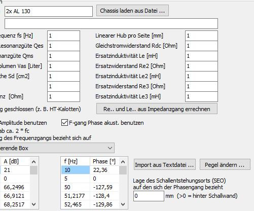

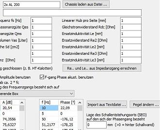

              Nop, tested. If you use Arta for measurements and import the data into Boxsim, yoi have to measure the time-delay in Arta, calculate the SEO and put that into Boxsim. If you don't do it, the phase is not correct. And that make sense:
              Measurement at 1m and SEO 0mm the delay in time is 2.915ms. The data starts at that point, including the phase.
              Measurement at 1m and SEO 30mm, the delay is 3.003ms. As before, th exported data starts at that point.
              So if you do not fill in the SEO and your tweeter has an SEO of 0mm and the mid 30mm, you're completely off.
              Measured, simulated and tested.

                      Stimmt also nicht. Ich habe die Weiche aufgebaut nach SImulation mit Messdaten und SEO auf 0mm und beim änderung Polung der HT, leichte Einbruch.
                      Weiche aufgebaut nach Simulation mit Messdaten und SEO erfasst aus die Messdaten und mit eingetragen im Boxsim: änderung Polung der HT gab ein richtige Einbruch.
                      Übereinstimmung Messung und Simulation gut.
                      Und wie gesagt, mann kann das einfach erklären weil die exportierte Daten (FRD Daten) vom Arta nur die Frequenz - Amplitude - Phase erhalten und damit hat mann kein Ausgleich vom SEO also muss diese separat eingetragen werden.
                      Kannst ja auch nog 'Visaton slash reloaded' lesen. Da sind auch die SEO beibehalten.
