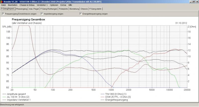

    I have the same problem
    I think we can use the AL130M
    the simulaton looks good
    (the technical specification from the TIW 360 is changed to TIW 350)
    (and it's a closed box)

      Hello moonwalker,

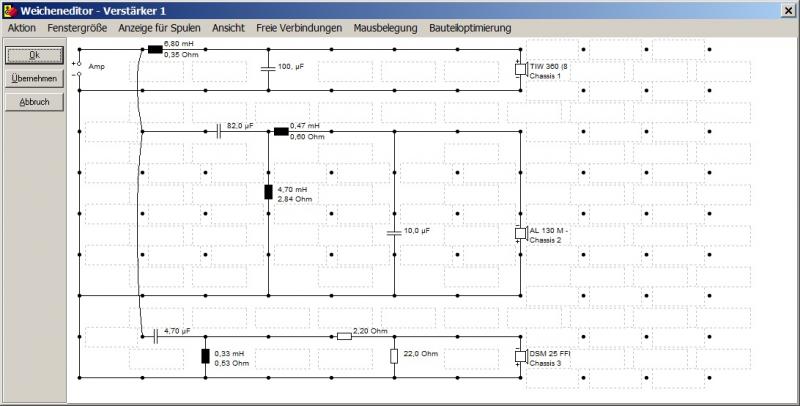

      yes, AL130 will be an option. The general problem: every alternative speaker does not work with the original crossover, so you have to redesign it, and measurment equipment will be very very helpful.
      If I had to do it, I rather would replace it with the Audax HM130Z10:
      http://audax-speaker.de/index.php?mo...ticles_id]=107
      similar gasket design, similar SPL, and less problems of cone resonances.
      Here is a boxsim-simulation with TIW360 and CBM130AW Data, extracted from an old speakerpro program.
      The boxsim simulation program is also aviable in english: http://www.boxsim.de/download/Boxsim120en.zip
      Greets Ralf

        I know the boxsim program but I can not use it. I do not understand all terms used in program. This is an impliction of my knowledge lacks. Additionaly I do not have any measurment devices. I am not sure if i can redesign crossover only use boxsim, even when I learn how to use it.

          Are Boxsim-data of the Audax-speaker available? I don't think so. Without the special data for Boxsim a simulation is not possible.
          The frequency response of the AL 130 M is very similar to the CBM 130 AW. Why don't you use the proposal of Locke? The simulation result with the AL 130 M looks very good. Remark: Use the M-version (midrange)!

                The M-type is a special midrange speaker. Due to a voice coil with less windings and therefore lower mass the efficiency is higher compared to AL 130 (the curve of the frequency response is higher, up to 90 dB). The CBM 130 AW had a similar high efficiency.
