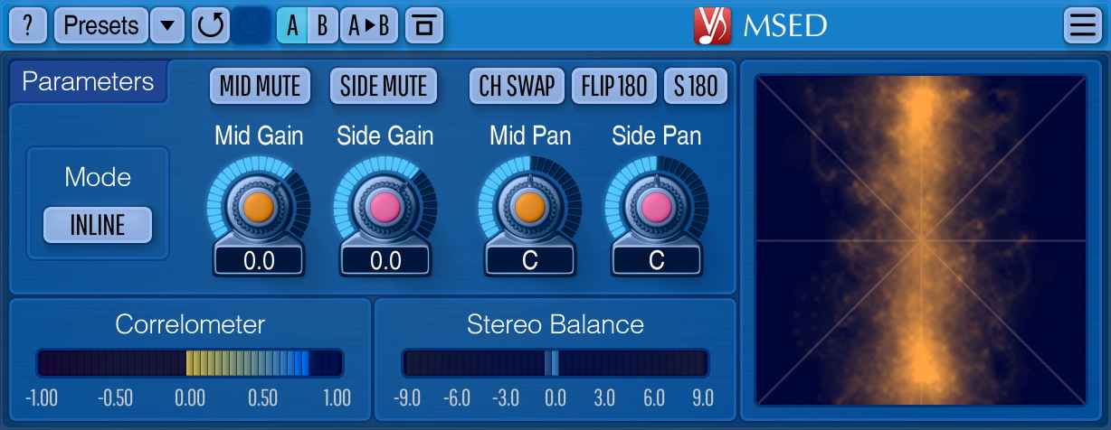

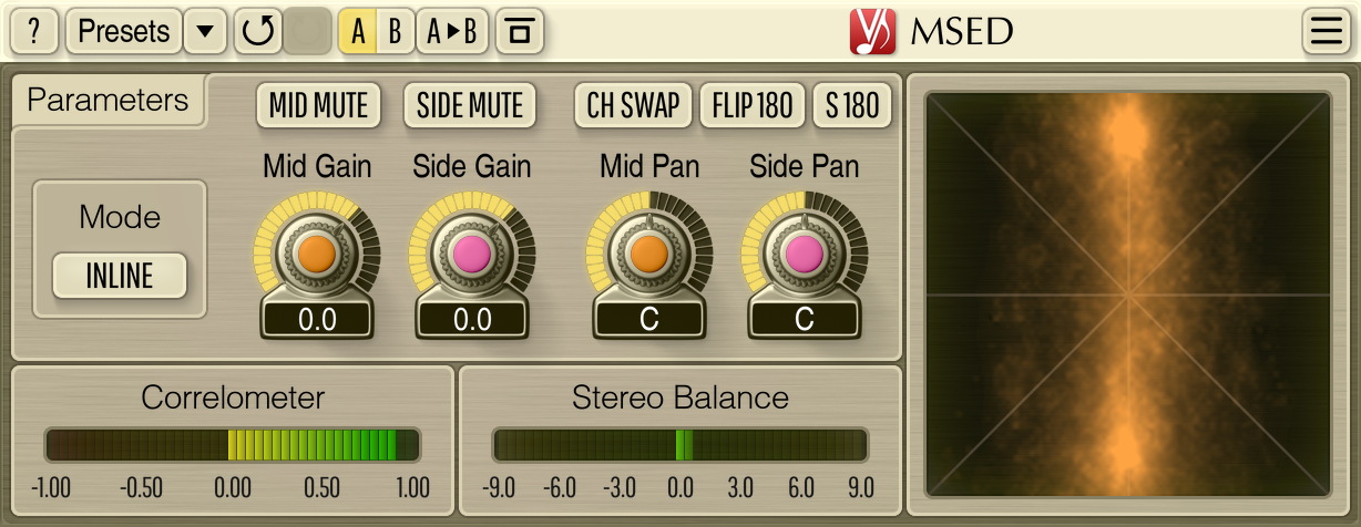

                                Während Kollege ProFosti noch in Verzückung mit seinem Kuhschwanz wedelt *g* sind andere schon Lichtjahre weiter :
                                ">The trick to getting the hotness out of the phantom center image is well known and used often by many mastering engineers. It's a dual channel parametric EQ inserted in M-S (mid-side) matrix. One side of the EQ corrects the center image, the other corrects the sides.
                                Mastering engineers can EQ lead vocals for example without affecting background vocals that are mixed off to the sides.
                                Many mastering processors use this process, but call it something like Spectral Imager (TC Electronics Finalizer) or some other voodoo sounding name.
                                The same process can be used to EQ the playback chain. If you use a computer to play back your music and have the ability to insert DSP plugins in your playback chain, there is freebie M/S encoder/decoder plug from Voxengo:
                                Free Professional audio plugin for mid-side processing which is able to encode/decode mid-side signal, adjust levels inline, and display stereo information.
                                You would insert one instance at the beginning of the chain- for encoding, then you would insert a dual channel EQ (with separate controls for left and right- not ganged), then you would insert second instance of the msed for decoding. Adjustments in the left channel of the EQ would affect the center image only, adjustments in the right channel would affect the stereo imaged sounds.
                                So a slight dip at 7kHz and 2.5kHz in the Mid channel, compensated by a corresponding slight boost in the Side channel would keep the overall power response constant and make flat voiced speakers sound right."
