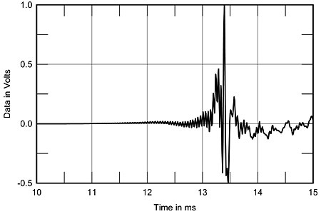

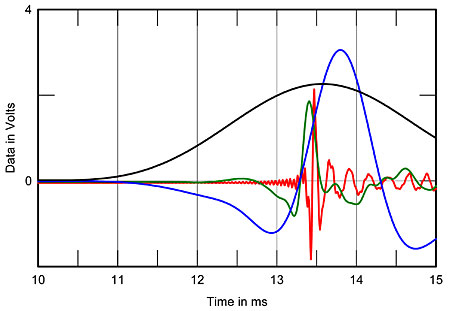

                  Zu FIR hatte ich das gestern gesehen:
                  Fig.1 Cabasse La Sphère, impulse response on tweeter axis at 1m (5ms time window, 30kHz bandwidth).
                  The tweeter's step is the red trace—the pre-ringing is presumably the residual effect of the Finite Impulse Response (FIR) high-pass filter, and the positive peak arrives just a little too late to sharpen the speaker's overall step. While this may well not matter subjectively, evident in the decay of the tweeter's and the midrange unit's step responses is some ringing that might well do so. (Both the filter's pre-ringing and the tweeter's post-impulse ringing can also be seen in the impulse response, fig.1.)
                  • doctrin
                    • 06.05.2006
                    • 2786
                    Ach ja da kommt wieder das Pre- und Postringing, Effekte die nie bewiesen werden konnten
