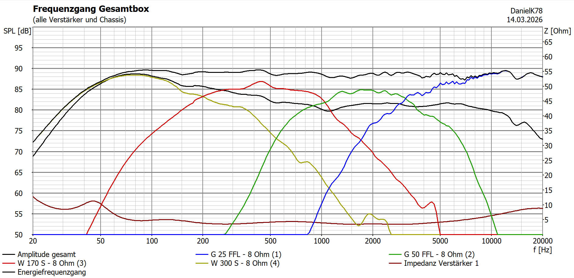

    Hello folks... I would like to make some good sounding speakers with W 300 S woofers... Single or double per box... Any suggestion for the midranges and the tweeters...? W 170 S for midwoofer, DSM 50 FFL for the midrange, DSM 25 FFL for the tweeters...??? What crossower to make for these speakers...?
    Zuletzt geändert von vladopalic; 13.03.2026, 19:48.
  • DanielK78
    • 11.03.2021
    • 523

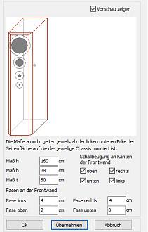

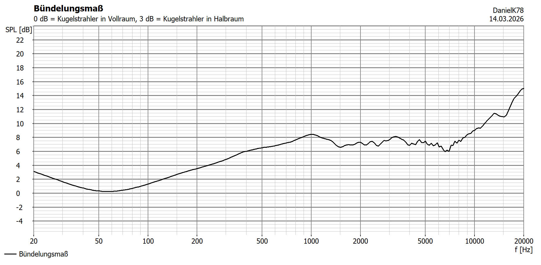

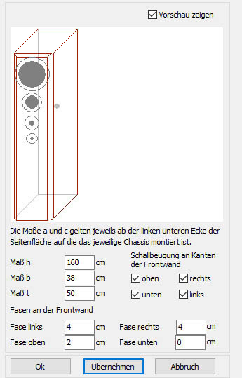

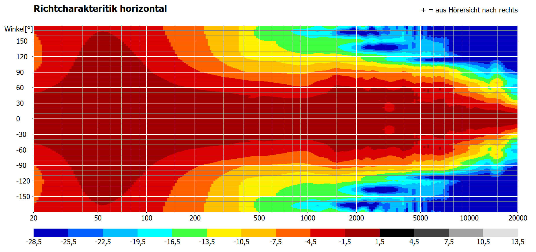

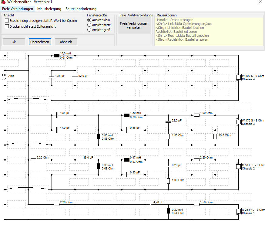

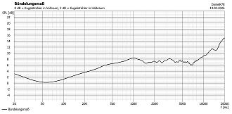

    Maybe this Simulation i made some years ago helps you as a working base. But you have to consider that this is a big thing!
    You have to make countless measurements and redesigns of the crossover...
    Simulation for Boxsim:
    4 Wege W300S W170S G50ffl G25FFL v4.BPJ

      For a speaker with the suggested DSM domes I'd take the Atlas Compackt MK 5 as a basis and go from there.
      Quick test with Boxsim: Switching TIW300 with W300S-8 and AL170 with W170S-8, and (in the mid-bass crossover branch) increasing the 100µF serial cap to 122µF and the 1,5mH serial coil to 1,8mH with a lower R (let's say 0,7 Ohms) will result in more or less the same on-axis response.
      However, compared to the original Atlas there'd be a minor inconsistency in directivity around 1 kHz, plus the W300S dataset comes from the older Boxsim 1.2 database (no angular measurements), plus this is still a simulation that should be confirmed / optimized with a real-world measurement.
