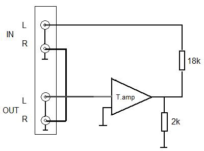

    I try to measure the FR of the amp, but I receive different curves from listed in http://www.visaton.de/vb/showthread....t=pm40c&page=3
    What is my setup:
Ansichten: 1
Größe: 10,8 KB

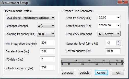

    Steps setup:
Ansichten: 1
Größe: 32,0 KB

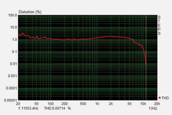

    Distortion:
Ansichten: 1
Größe: 47,1 KB

    My questions are:
    - Is the measuring setup correct and STEPS is configured properly?
    - The distortions looks similar to the other listed in the thread for pm40c but I'm not sure.
    - I can't post the graphs of the FR because i reach the limit of attachments, but the FR looks different. I will post soon.

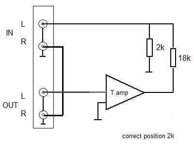

    Hi drakano,
    seems like you want to use these 18k and 2k resistors as a voltage divider. Thus the 2k has to be connected to the other terminal of the 18k. How it works:
    • output voltage of the amp is input voltage of the divider
    • divider consists of two resistors in series, current is driven through 18k at first and then through 2k to ground
    • current is input voltage divided by sum of resistors equals 20k
    • output voltage is current multiplied by 2k
    • output voltage is measured

    • drakano
      • 13.10.2011
      • 2
      You are right, this is correct divider:
