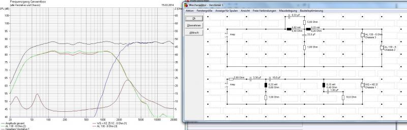

    I have a Visaton Couplet speaker kit, and now I'm wondering whether to build it as a shelf-speaker or as a standbox-version. The problem is that I really can't find much information about the standbox-version. I know that it can be found in Hobby Hifi 5/2000, but that article is out of my reach.
    Some of the questions I'm wondering about are as follows: What are the advantages or disadvantages of the standbox over the shelf-version? Does the standbox require a different crossover? Is it possible to find plans for the standbox? Or does someone have a copy of the Hobby Hifi article (maybe I can understand it with Google Translate)? Any other information I should know of?

    Is your question about Couplet Standbox without waveguide? If so, the only advantage i can see is about optical reasons. As you can see in my threads (search for it), i've built a Couplet Standbox with Waveguide - you can built it for a shelf as well. There are no disadvantages for the different versions.

      But you can also use the original Couplet crossover. Volume for each TMT is 15 L with BR 19.24. BxHxT 200x1100x300. The Crossover-compartment at the bottom ist sand-filled, H=300.
      The use of a subwoofer depends on the hearing level.
      Pansen mentioned Couplet with Waveguide, this Speaker ist much better.

          This is not an official Kit, the crossover must built by yourself.
          Waveguide is made by Visaton WG 148 R.
