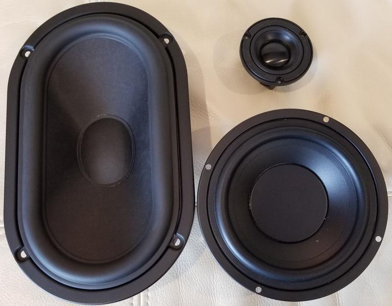

    I am thinking of building a desktop computer speaker for a friend using the Visaton W 130 X subwoofer, Vifa/Peerless NE65W-04 full range and the SB Acoustics SB15SFCR-00 5x8 Passive Radiator.
    Any experience with either the W 130 X or the little Vifa?
    Does this seem like a good idea or a bad idea?

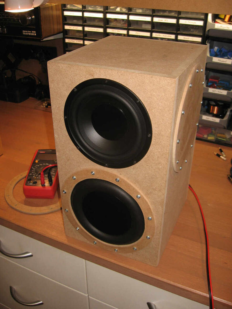

    Hi, the Peerless is sitting in this beauty and does a great job
    https://quint-store.com/lautsprecher...f-a-s-t-studio
    2 legit 2 quit
      • 2432

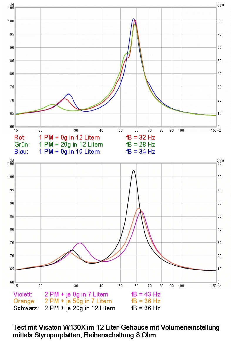

      Why not go for the PACTO (using the FR58)? They sound great and converting to a passive radiator should be a good idea, I don´t like the folded ports VISATON is using either. The SB "race track" radiator (on the backside) is worth a try. My own work on this issue landed on the back burner but is not forgotten. Using a very simple radiator https://www.amazon.de/IPOTCH-Lautspr...ci_mcx_mr_hp_d with approx. 60g moving mass I got there:
