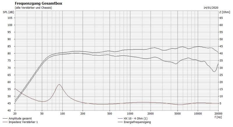

                #52
                ok ^^
                how much space your daughter has for her speakers ?

                          #57
                          Suggestion:
                          HX-10 in 6,5 liter closed (1-2)
                          https://www.visaton.de/en/products/c...rs/hx-10-4-ohm
                          • Willy_65
                            • 13.12.2018
                            • 77
                            #58
                            Thank you Jama,
                            That looks like a good proposal: @ 10dB = 50Hz-20kHz.
                            Only the lower I would have preferred something less, viz. 40Hz, but that's probably a utopi due to the limited space.
                            That's why I think I'll build them unless a better alternative comes up.
                              #59
                              or Pacto ?
                              https://www.visaton.de/en/node/872
                              Zuletzt geändert von jama; 14.01.2020, 09:02.
                              • Willy_65
                                • 13.12.2018
                                • 77
                                #60
                                Well found Jama!
                                I can get on with this, I believe it can meet all the conditions, this will be something to thoroughly examine next week.
