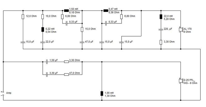

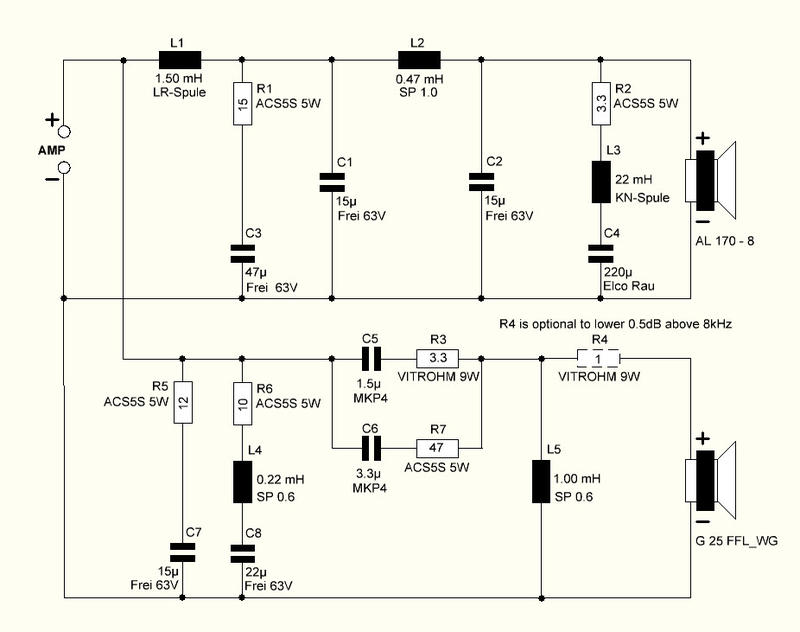

OMG 23 componentes for a 2-way crossover...
Here my suggestion(-9 components)
Angehängte DateienZuletzt geändert von nlcarbon; 28.12.2019, 14:30.Kommentar

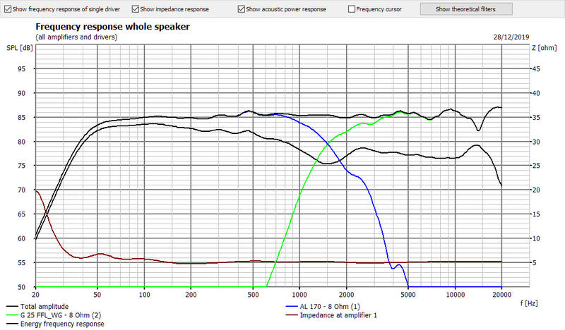

No, but 19 components (without LS) and that for excellent results!
- frequency curve without large waves or peaks
- frequency response in the band 10dB = 32- and at 6dB 38-30 kHz
- perfect takeover at the crossover point
- very good frequency response directions to top - right and left
- ideal flat impedance line of 5 ohm for tube amplifier
Cost for 2 crossovers (including the PCBs) = 125 €
For a set of boxes that cost € 470, including crossovers but without housing, the quality must prevail. That applies to every part!
Otherwise, you might also equip a Porsche with a VW Beetle engine

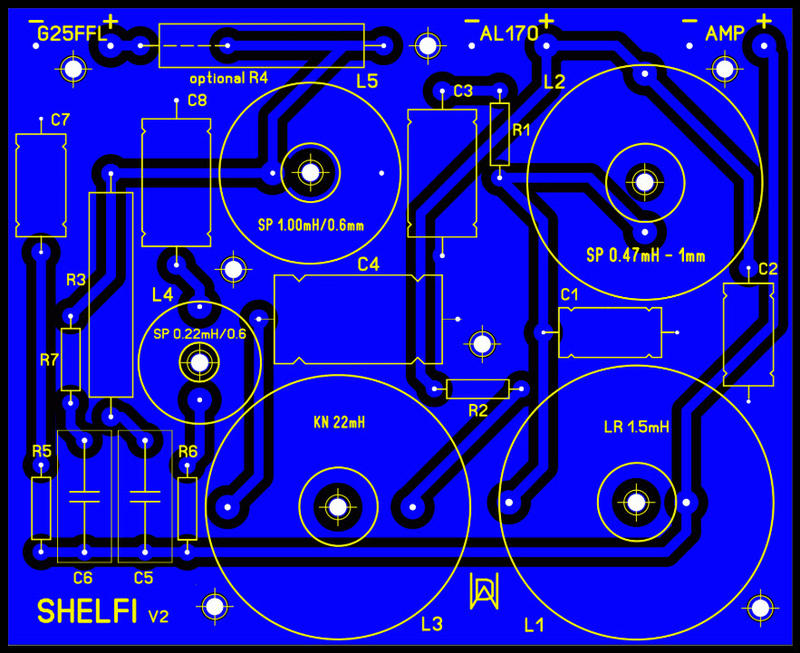

The circuit board is designed, I am still waiting until after New Year to place the order.
If there are any comments in the meantime, please let me know in time.Kommentar

Here a info how to place the coils:
I have looked at your proposal, but then we are back to the point that we already reached a few days ago.I added a option with less components in #32
http://www.troelsgravesen.dk/coils.htm
The impedance curve is fine for solid-state amplifiers, but less good for tube amplifiers: too low for 8 ohms and too high for 4 ohms. Moreover, the resonance at 60 Hz is not eliminated and tube amplifiers do not like that.
That is why I opt for Uwe's proposal, which means that the impedance curve is straight 5 ohms.
All this without compromising on the "flat" frequency characteristic and perfect phase transfer, although with a different concept and addition of some parts.
The link that you sent for placing coils on a PCB is interesting, but it teaches me that the induction deviation of 2 coils connected in series, gives a reducing of 3% when placed next to each other.
Good to know, but when it is difficult to do otherwise, it is also not so bad.Angehängte DateienKommentar

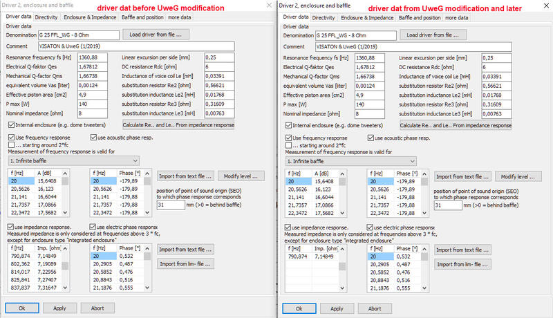

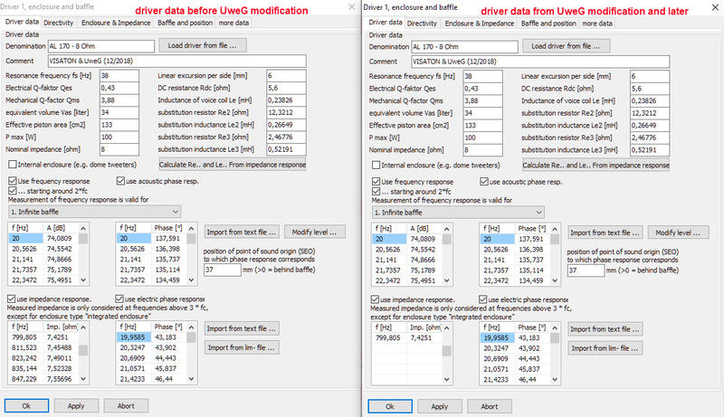

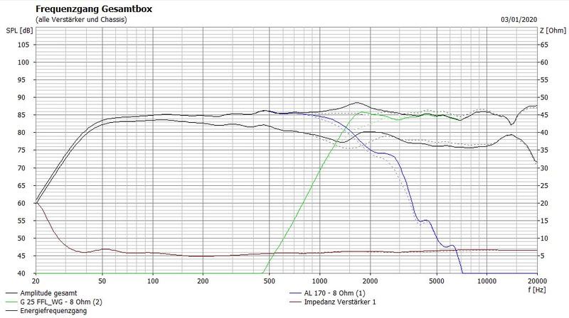

Hello Willy,
I noticed an error in the BPJ file posted in #27 by UweG. Your modified version probably has the error too. The impedance data for both drivers are incomplete. Therefore, the simulation result is not correct.
You can restore the correct impedance data by reloading both drivers from their files. Then you will notice the response is not optimal. So you will probably want to revise the crossover. I hope you have not ordered all the parts yet.

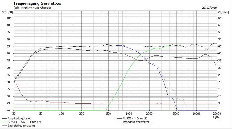

I am attaching two suggestions. Version FR2 takes some extra parts, but version FR4 does not. The results are similar. I am not sure which one is better. The directivity index is slightly smoother for version FR4, while version FR2 maintains a better frequency response in the 10 degrees up and down directions.Kommentar

@UweG:
Any idea why the impedance data from the speakers suddenly stops at 799Hz in your adjustment?Kommentar
effectively there’s a mistake seeing the f-gang
I recharged AL130 and G25 Ffl-WG
I will choose the version FR2

Hello Willy,
sorry for the mistake. It happened because I used a not published temporary version of Boxsim that had a bug.
To be honest, I do not like this additional capacitor in series with the tweeter, as it shifts the phase in the wrong direction und makes the energy response worse.
Attached please find my suggestion to repair the bug. I liftes up the directivity a bit and tried to smoothen the enery reponse.Angehängte DateienZuletzt geändert von UweG; 03.01.2020, 10:25.Boxsim ... wenn Lautsprechersimulation gelingen soll.Kommentar
Hello Uwe,
I agree that the additional capacitor in series with the tweeter, shifts the phase in the wrong direction and makes the energy response worse.

Thank you Uwe and Fraggle for discovering the error and for the adjustments while maintaining perfect phases, good power response and good frequency response directions for the shelf speaker.
