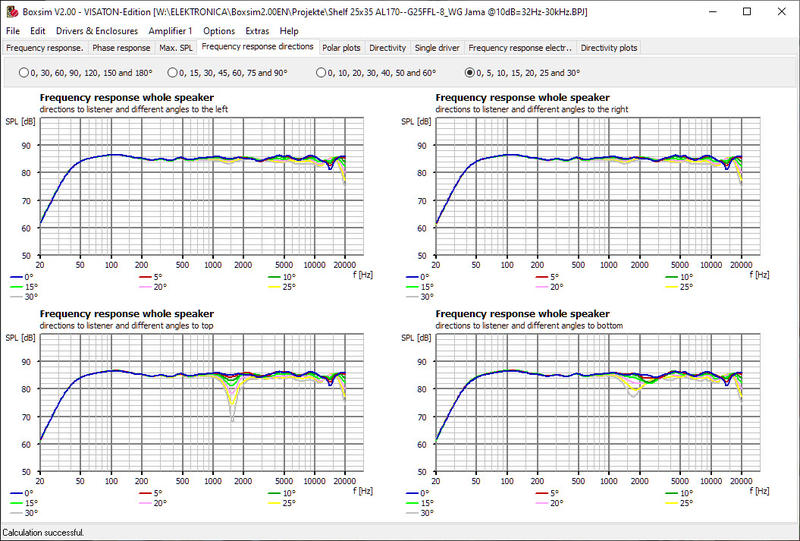

        @jama
        I now understand how to set "Baffle and position" for a more accurate simulation.
        As with the Couplet, I use 1.8 cm left and right chamfers and I am very satisfied with the result.
        6dB = 37Hz- @ 10dB = 32Hz-30kHz

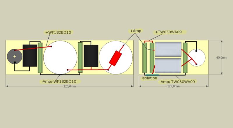

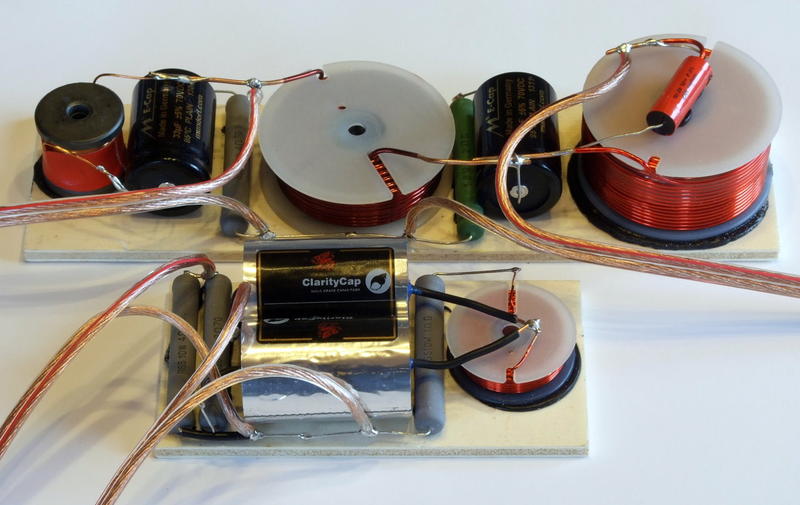

              Thank you Jama and Walwal for the expert help.
              I have ordered the PCBs, the finishing of the boxes themselves will have to wait a while, there are other activities in house (paints and wallpapering) that must now be given priority.
              @walwal: did you make the front panel of those boxes yourself or by a carpenter, from solid wood? What was the thickness of the base panel?
              @jama: which check boxes would you tick for the best simulation in the setup and space given below? Top + right and left or right and left only?

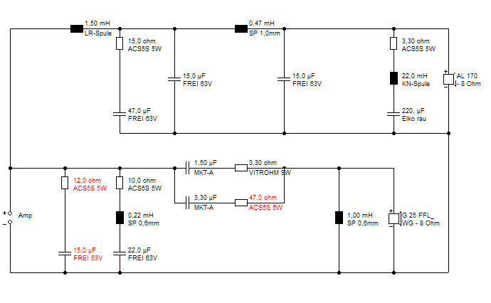

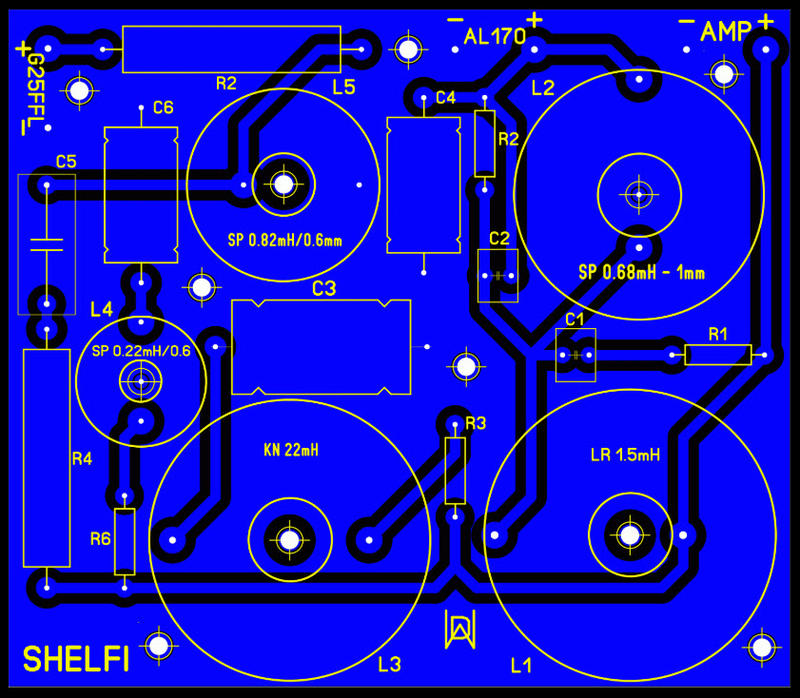

                    review the layout
                    • Willy_65
                      • 13.12.2018
                      • 77

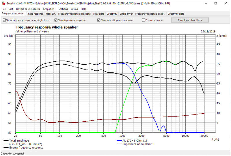

                      Hi jama,
                      Indeed you are right, the R2 above L5 must be R5.
                      I had brought the value of that resistor from 2.7 to 2.2 because the top at 9kHz than is 85.5dB, just like the top value from low at 108Hz.
                      I know, it's just peanuts, at 2.7 ohms it's 85.25dB.
                      Is there perhaps another reason why you prefer 2.7?
                        now ! 2,2 is ok ^^

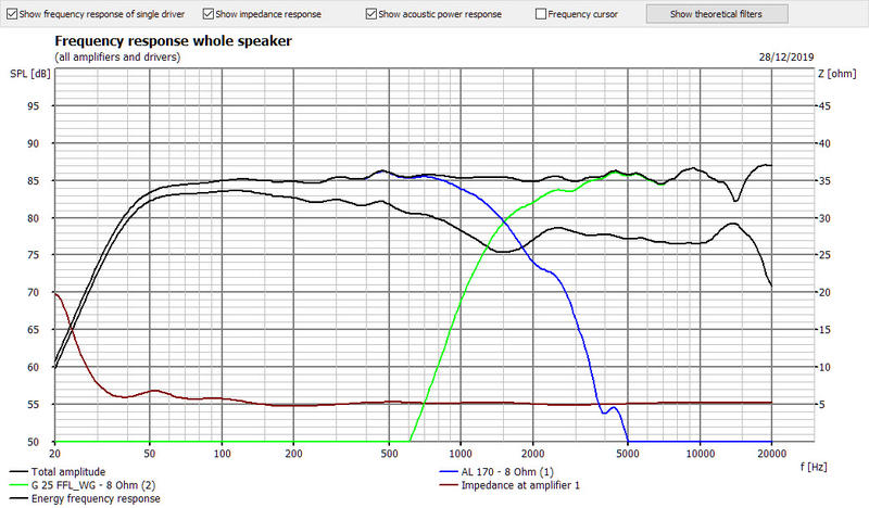

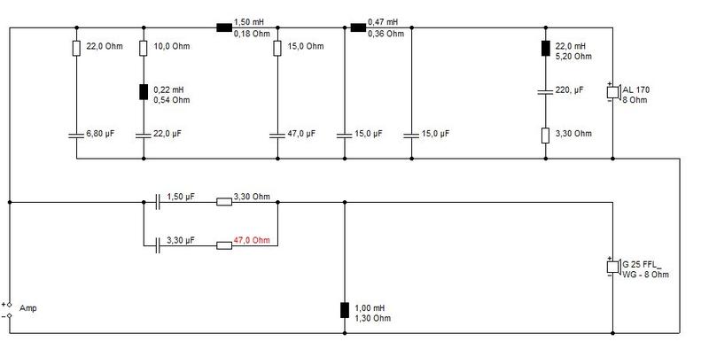

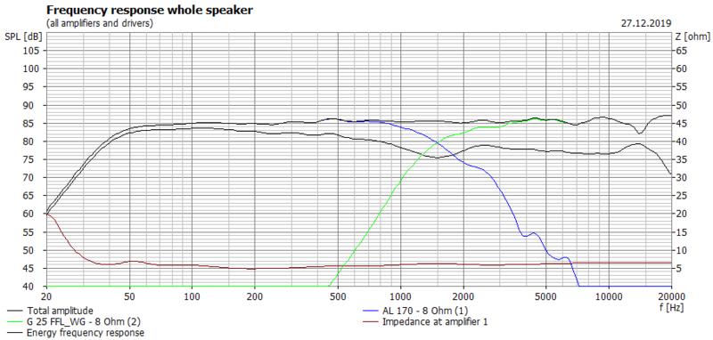

                          • 5691
                          I actually do not understand the target of this design. This high amount of parts for the crossover could be used to get a much smoother response. Is it not intended to get that result?
                          Seee attached file as an example. I also switched on the diffration at the top edge for the woofer.
                          • Willy_65
                            • 13.12.2018
                            • 77
                            My mouth falls open with surprise.
                            I will be happy to design and order new prints, which will cost me another € 18 (total for a minimum of 5 items), but that is negligible when I see this design.
                            - The frequency response is almost straight across the line, @10db = 33Hz-30kHz
                            - The phase transfer is perfect at the crossover point
                            - Frequency response direction to the top has been improved
                            - Impedance curve is almost straight and with an average of 5 ohms ideal for a tube amplifier at 4 ohms.
                            Thank you Uwe!
                            Thank you too, Jama, I was answering that I did like your last modification, but in the meantime the message came from Uwe, and ... that result is the best I can imagine.
                            Zuletzt geändert von Willy_65; 28.12.2019, 08:46.
                              Why don’t you cable up like that example?
                              Zuletzt geändert von jama; 27.12.2019, 21:50.
                              • Willy_65
                                • 13.12.2018
                                • 77
                                ... impedance fine tuned to 5 ohms and 2x 22 ohms replaced by 1x 47 ohms.
