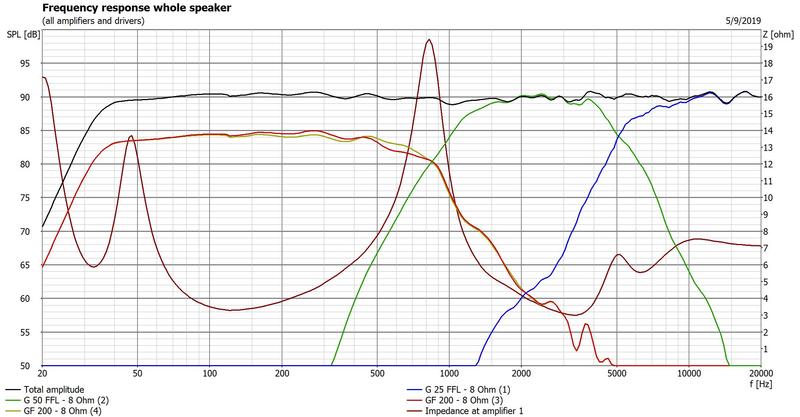

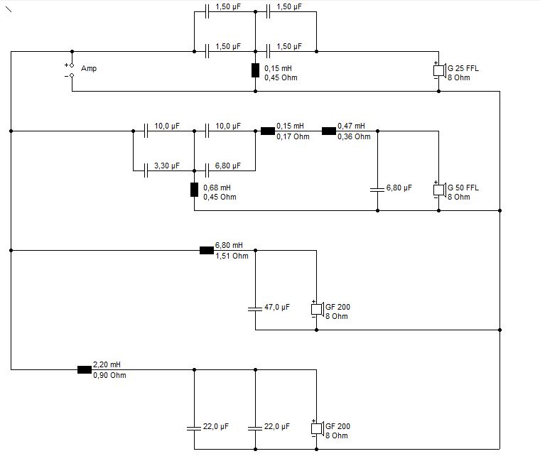

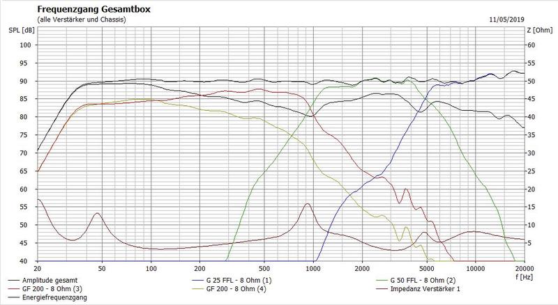

The USA does not have these drivers but I can get them from Solen.ca in Canada. Because of the limited availability of these drivers in North America there is much info on them on English based forums. I have been planning a three way speaker with double woofers and wanted to see what German users more familiar with these drivers think of this setup.

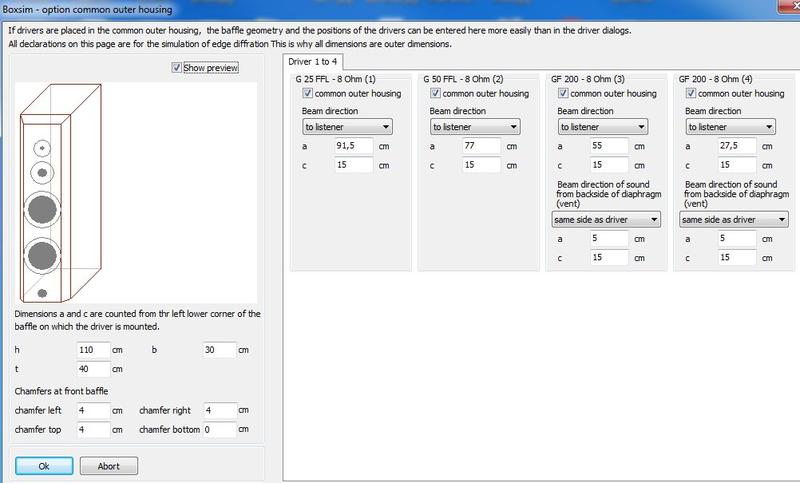

Here is the crossover, frequency response and driver layout in Boxsim.
Any comments would be appreciated!
