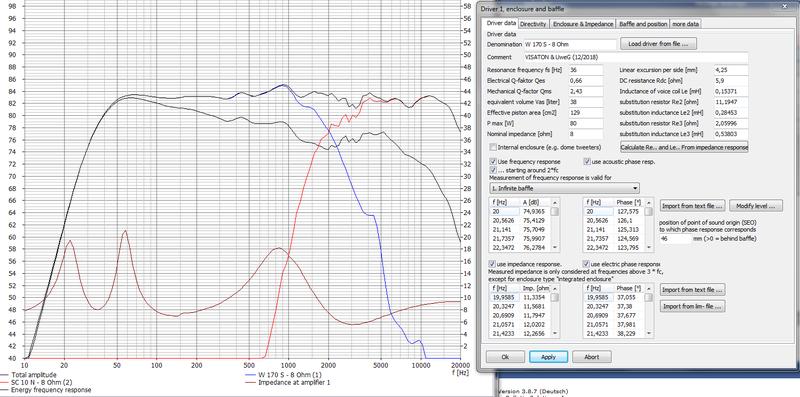

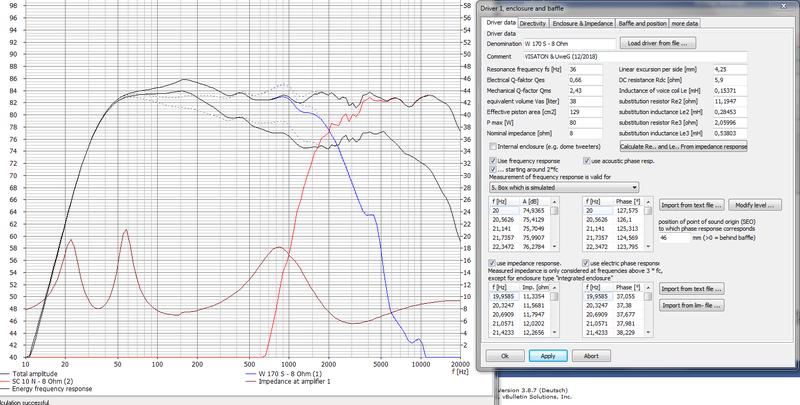

      I would have a question, as currently I'm a bit puzzled: in the driver selection dialog, what is the purpose of the "Measurement of frequency response is valid for" dropdown?
      I've attached two images, one of them shows the original setting with "Open baffle", the other one is for "Box which is simulated".

          You do not have to change any setting of the place where the frequency response refers to. This is set automatically when the driver file is loaded.
          Possible settings are:
          - infinite baffle: automatically set by all new diver files, as their data is already recalculated to the infinite baffle (=half space)
          - DIN-baffle: set by some of the elder driver files
          - VISATON test enclosure small or large size: set by many of the elder driver files
          - box which is simulated: This should be set by you after you imported an own frequency Response measurement of the Driver that was mounted in your box.
