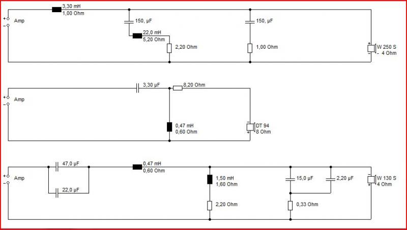

    Hi! I've been designing a speaker with Boxsim and I need someone who knows more about loudspeaker to look at the project and check out what problems it might have. I figured this is the best place to ask, except I don't speak German! I haven't designed a speaker before and I don't really know all that much about all the different mistakes I can make.
    The project is to make 3-way loudspeakers out of two cabinets of an old desk. I don't have the actual desktop, only cabinets. They look nice, so I think the best way to make use of the cabinets is to turn them into loudspeakers!
    I chose the drivers and made the crossover (I know very little about crossovers) in order to straighten out the frequency response. However, I don't know if I caused some other problems. If anyone could take a look at the project file and offer some comments (in English), they would be much appreciated!

            Hello brkl,
            here´s my proposal for your speaker. Take the W 130 S as midrange. It is way cheaper than the AL 130 but still a very good midrange driver.

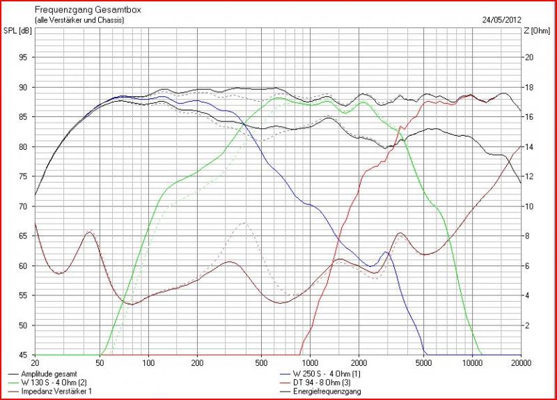

            I optimized your simulation in order to obtain a very flat frequency response and good phasing. You can check for correct phasing very easily: Just reverse the polarity of one driver. You should see a deep dip in the overall frequency response where the two drivers cross. If the dip is not very deep, it is not optimal. If you have no dip at all or even at some points the overall SPL in the transition region is higher than the SPL of a single driver, you´ve done something terribly wrong
            Please note that, as the W 130 S is a cone driver which is open at it´s rearside, you need an extra housing for it. You cannot put it in the same housing with the W 250 S! Just build a little wooden box or take a flower pot or something and glue it behind the hole of the W 130 S from the inside of your cabinet. The volume should be around 3 Liters, according to my simulation.
            Best regards, Martin

                I would have a light modification in martin's simu...
                The sound will so be warmer and English...

                    I don't like that dip in the highest frequencies that DT 94 has, but I suppose beggars can't be choosers. I can probably live with it. Very strange about the missing data of the DTW 72, good thing I didn't just start building!
                    Jama, is your modification just to change the impendance, or both the impedance and the frequency response? I'd prefer neutral to warm sound. I suppose low impedance would mean that I would have to be careful in regard to what amplifier I use.
                    There was a nasty dip in frequency response at the W 130 S - DT 94 crossover frequency around 30 degrees towards the top. Since the speakers are quite low, this could be a problem. I switched the places of the tweeter and midrange drivers, which made the dip happen 30 degrees towards the floor -- which is not a problem Any comments about this? Most speakers I see have the tweeter higher than the midrange.
                    Thanks again for your help
                      @brkl
                      Can you see the images?
                      The additional capacitor (22 micro) acts only lies between 200 and 700 hertz...
                      In dotted line without her.

                          @brkl
                          Ah, sorry, I simply got confused because the scale changed.
