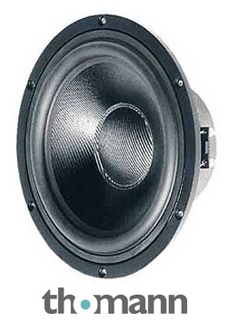

    Hi . i got problem .Woofer al 200 it cost to much in project Visaton vox 200. Can i use diffrent woofer : VIFA P21Wo-20-8" or Dayton dc 200 -8-8" whyfe same crossover. THANKS

    You blame the Al200 for being too expensiv but not the Ti100?!?
    I don't know where cou live, bur here in Germany the GF200 can be bought pretty cheap!
    http://www.thomann.de/de/visaton_gf_200.htm
    This is according to Visaton exchangeable! The TSP are very similar.
    If this Woofer is also too expensive: Look for another speaker than the Vox 200!

      Build it with the GF!!! Also its possible to built no Vox, but a Loudspeaker with 1 AL200/GF*/TIW* ; 1AL130* or TI and the KE. Now built no sidebass and raise the cut off frequency. So you safe money because of the "cheaper" crossover and only one AL130*/TI .
      -> Classic 200 http://www.visaton.de/de/bauvorschla...835/index.html
      Also this loudspeaker sounds a "bit" more realistic.

        Build it with GF 200! I have these Speakers in my home - VOX 200 MHT/GF. Is very good in the bass!
