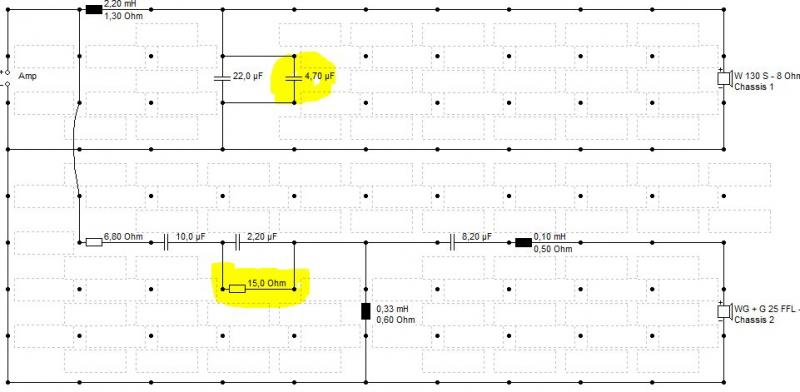

    Hello to you all,
    Can someone help me? Is there someone willing to develop me a crossover for the “Studio 2 light” (G25FFL + W130S)? Or is this not possible? You can write back in German. I can read it but i can not write it so well.
    Thank you very much for the one who is willing to develop the crossover.
    • 28863

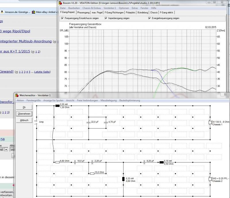

    First: This is a simulation, reality maybe different! And the tweeter needs the waveguide.
    Take the original crossover and change ist as shown here. Frequency-response ist very similar to the original (dottet line), but the Maximum Power is lower. N0 guarantee.
    Good luck
